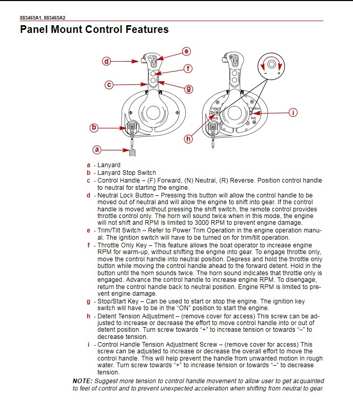

#20 Post by Bamby » Thu Aug 04, 2016 7:33 am
Here is an example of a Mercury control and this one actually has two ways to set the motor into fast idle or enriched starting mode.

#21 Post by Likesspace » Thu Aug 04, 2016 6:11 pm
Bamby....
I really appreciate the time you took to make this post but unfortunately that doesn't apply to my control. I've looked everywhere on this control and there simply is not any type of fast idle button or adjustment. It seems that this control simply relies on priming the carbs and starting at idle. Having said that, after pumping the bulb until it's rock hard, the motor starts effortlessly.
