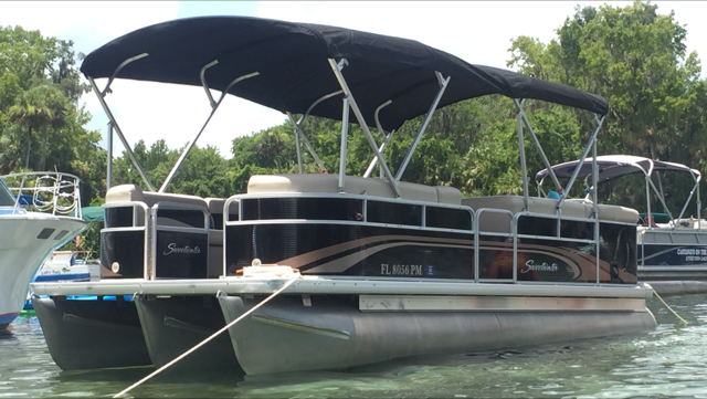

I think weight distribution has more to do with it than you think. My buddy has a 24' tritoon that has the rear loungers on it with a 200hp, the rear loungers push his helm further forward than most boats. I have a 22' tritoon with 150hp has the traditional cruiser layout so my helm is further back and my boat will outrun his any day of the week simply because I can get more boat out of the water creating less drag. When my boat is trimmed out I can get the bow up fairly high.
