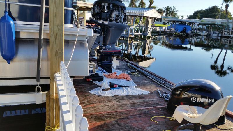

While the boat is on the lift, I was able to borrow the neighborhood's "mini-barge" with electric trolling motor and tie up to the back of the dock. This worked great and I didn't drop anything, not even one drop of oil in the canal while doing the 20 hour service.
