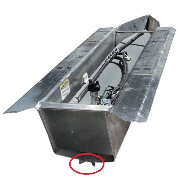

Pontoons are very difficult to prop correctly... Motor height is very curtial as is motor trim, as is load (passenger) distribution etc.
If your motor-pod has this V-Guard on it you might ask the dealer to confer with ST about removing it as it just hastens prop blow-out...
- pod%20v_zpsjqdajcjh.jpg (57.85 KiB) Viewed 6289 times

As for the piece of metal on the bottom of the gas tank piece, I'm not sure, will have to investigate.
Currently the motor is as low as possible on the transom. If me and my wife are on the boat, there are no problems, but once there are 4 adults on board with two sitting forward, the motor starts having the gurgling noise and starts slipping on the water. Trim all the way down still doesn't help.

Cut the thingy off the motor-pod, my motor would do the exact same BS even with 2 people on board if I didn't have a full tank of fuel... Now once cut off you might very well need to then raise one hole on the transom....

Wow thats crazy that the little piece of metal made such a difference! I'll definitely cut it off, or have them cut it off.
