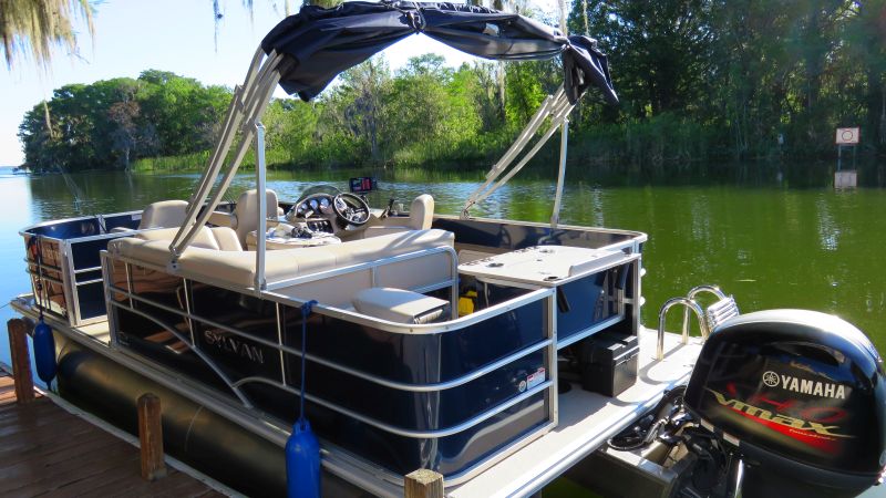

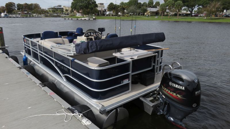

I have a 2016 8520 Sylvan RPT (version 2.0) with the 4 stroke Yamaha 115 SHO. I'm very happy with the SHO and it cost around $300 more than the 'standard' 115. This Sylvan is rated for 120HP. Good to hear the 115 SHO is rated up to 130HP. I wasn't sure of that... i topped out at 37mph on GPS. I forgot the exact pitch and diameter of the aluminum prop the dealer put on. The RPM's are slightly low at 5600 to 5800. I'd like to reach 6300rpm.
Jim, I think you are going to really like that SHO!
- Sylvan2016-8520-1s.jpg (96.04 KiB) Viewed 4388 times
- IMG_1596-2c.jpg (105.21 KiB) Viewed 4389 times
