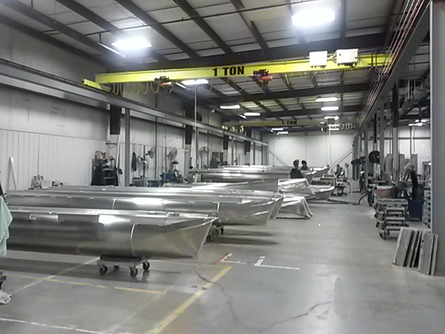

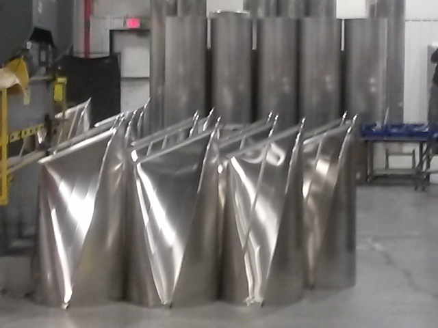

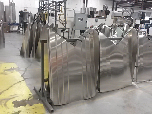

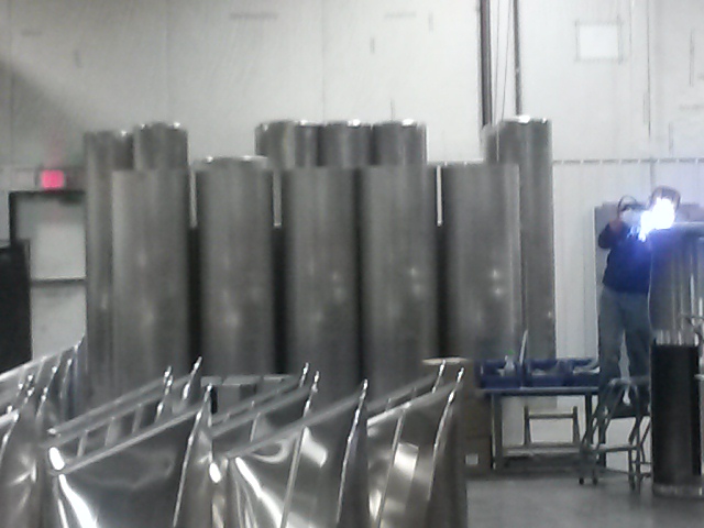

Here are some pictures I took during a visit with Manitou. The nosecones start as flat aluminum, are cut and creased, then rolled by hand and welded. Then the keel is welded to the front, over the leading edge of the nosecone. then the pontoons are rolled and welded. Then they are put together on a large set of rollers and the tubes are welded together for whatever length the pontoon is. The nosecones and endcaps are then welded on. Its a cool process to watch and these are all hand welded and come out looking fantastic. These guys know how to lay some welds.
