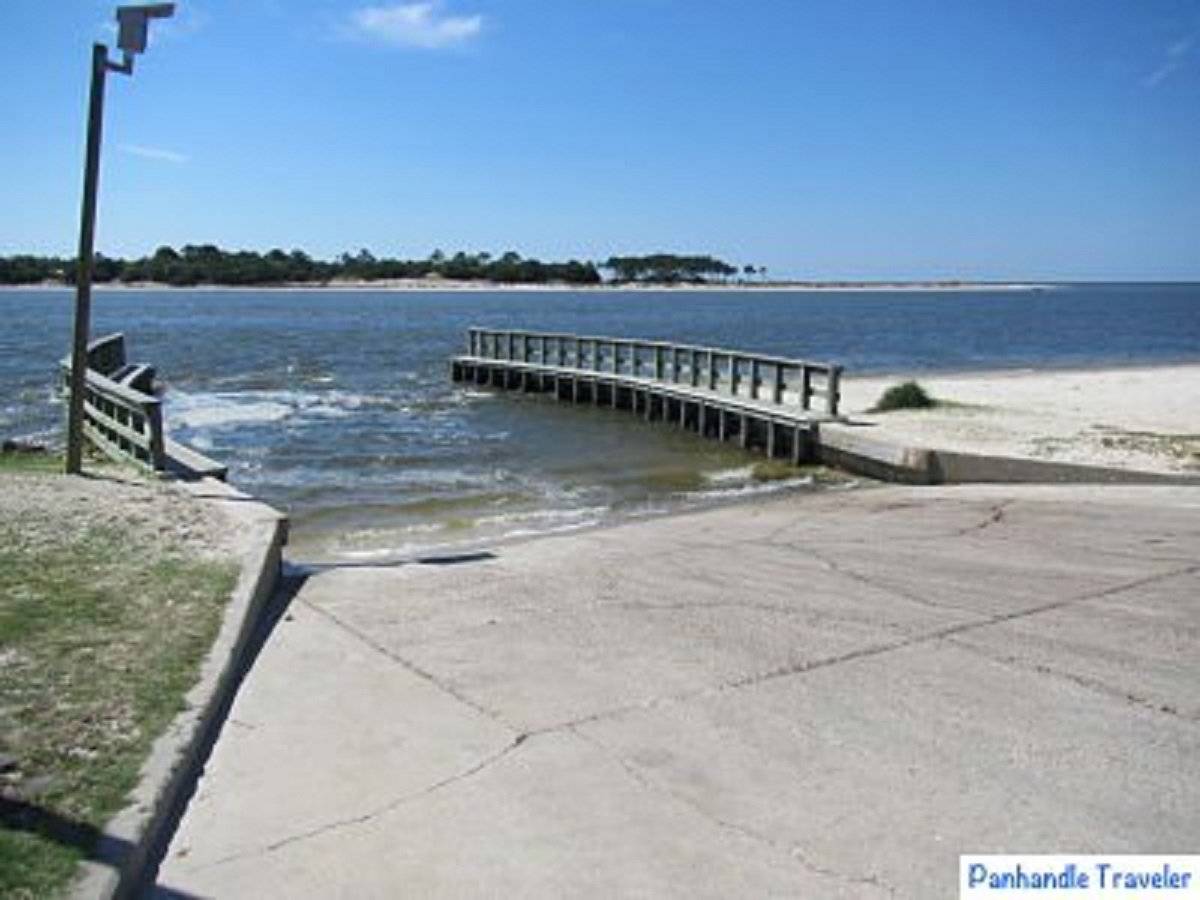

Thanks. I am having no problems loading at the lake and had mentioned to my wife we would need some guides before loading the toon at Indian Pass (pic bat bottom see red arrow for ramp). The Indian Pass Ramp is just that a ramp in the pass on the edge of the GOM. It makes for some pretty interesting loading at times. Tidal currents, wind, & wave action on the approach can get you into making the mistake of using to much throttle. I pulled a pic (below)off the net that you can see a little of how the current is there at times.

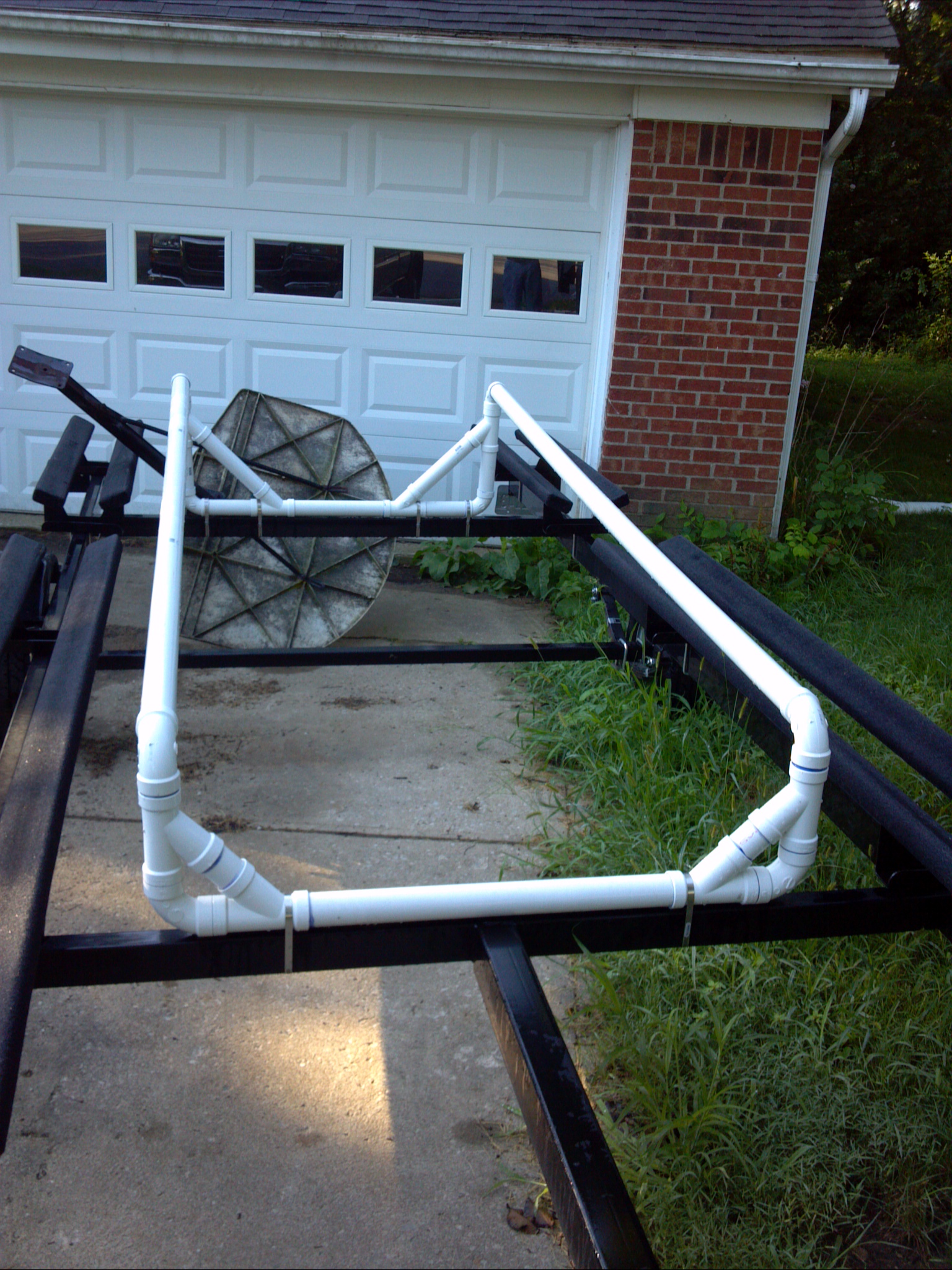

I ended up making my own guides out of 2" PVC. I've got about $80 dollars in it maybe and it solved all my problems with loading. In fact, my wife loads it every time now its so easy. I got the idea from someone on this sight and the picture below is from his trailer.
