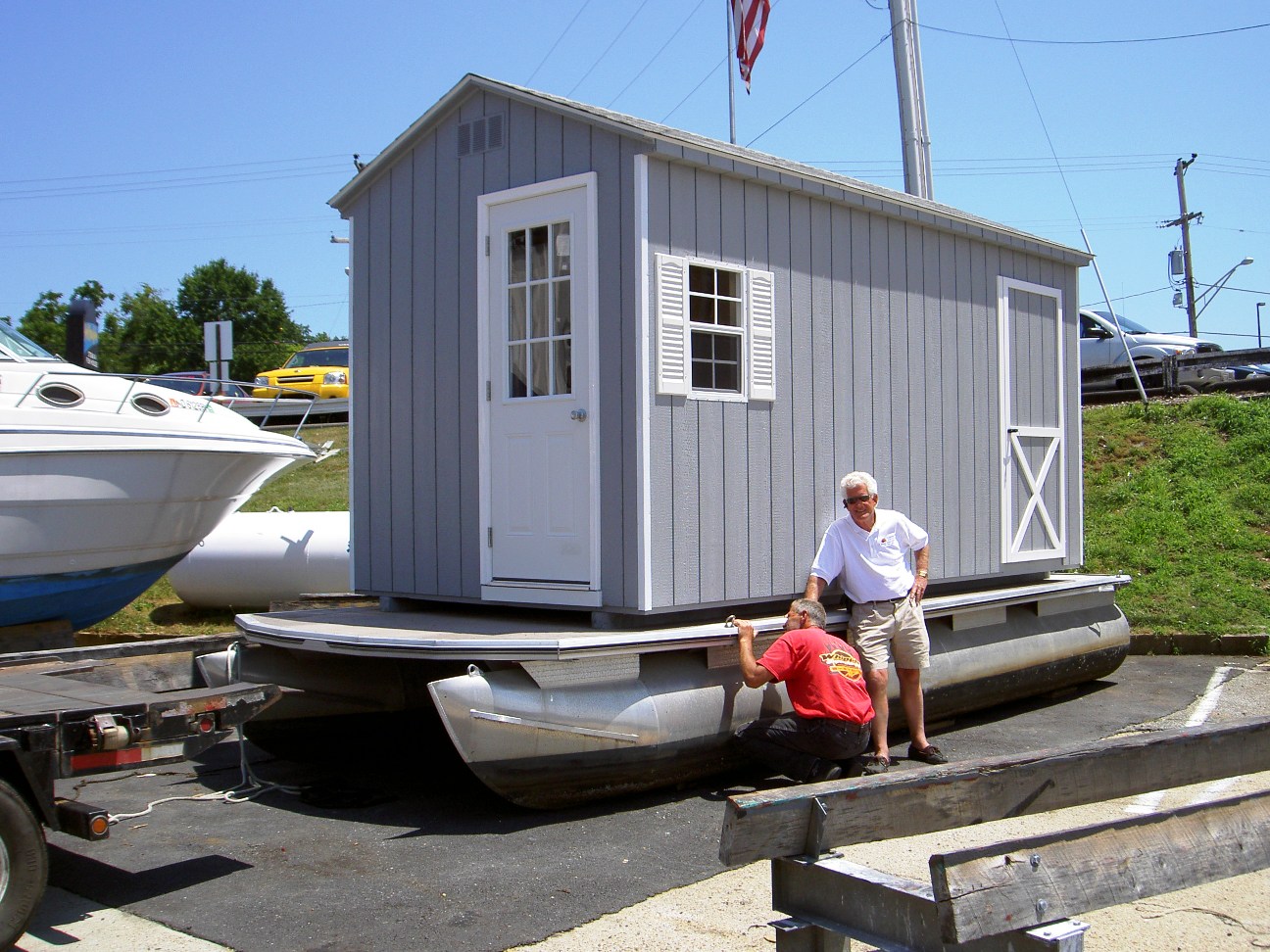

I'm with Bamanan on this. Just get yourself an old used pontoon (there are lots out there), clear the deck and build your structure on it. If its not going into any rough water you could even extend the deck both fore and aft for more sq feet. Go lite as possible on building material ie aluminum studs and such. You could even pull the wheels and axle off a camper/trailer or get a shed and put it on and save yourself more time and money. It's been done many times.
- 2011_HOUSE_BOAT_2.jpg (336.18 KiB) Viewed 15856 times

I build this 24 ft with a 2" alum. sq. tube frame, alum. clad foam panels and acrylic windows. It will sleep four people and has propane stove/oven,shower and port pot. You can live aboard and still use it for fishing etc. Sorry couldn't find the picture, i'll attach one later today.
Re: New Guy on the Slip building a pontoon house
OST for picture of above
had not seen that emo, so I used it
