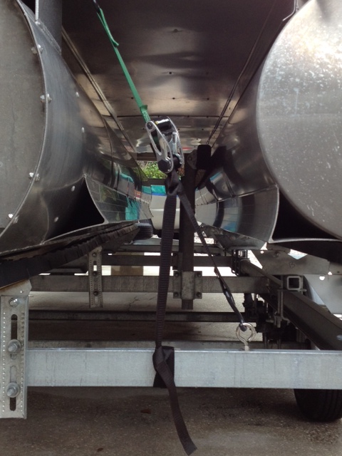

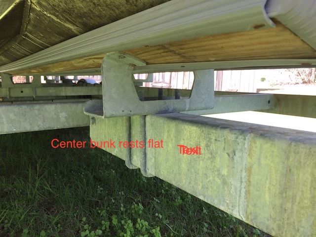

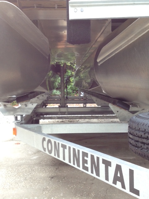

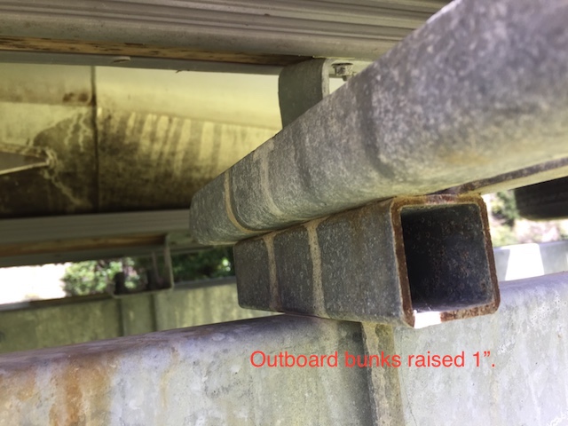

Here's your answer.
Do not lower the center bunk.
But, do raise the two outboard bunks one inch with a 1x1. That's what Magic Tilt Trailers did for mine.

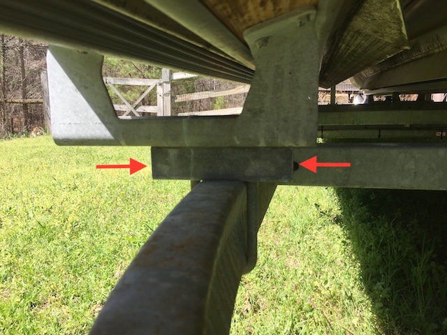

My boat had the same issue and we did it the same as above. Used 1" block under the outer pontoons and left the center to rest on the trailer frame. If you look at the outer brackets youll see we had to modify them so the boat will rest on the pontoon and not on the lifting strakes. In the first pic you can see on the center pontoon near the rear the pontoon has a flat bottom, the manufacturer calls this their "launchpad." We modified that section also but it doesnt look to be touching in that pic for some reason... I had to readjust it.

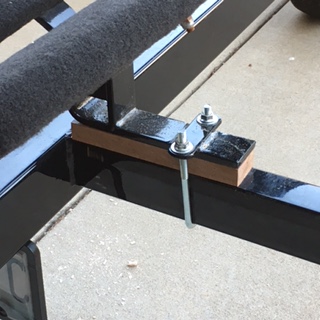

Finally finished. After several phone calls and emails and waiting 2 weeks for parts that never came. I took the advice of fellow pontooner's here on the site. I made the 1" spacers out of 100% recycled PVC decking material. Ordered longer U bolts and started wrenching. I attached the spacers by using countersunk self tappers into the frame and added a little marine adhesive to secure the blocks. I then attached the outer bunks with the longer U bolts. I then installed and centered the original brackets they sent me and installed the newly carpeted bunks into place. I used the cut sheet form Harris to set the bunks to the right dimensions.
I am very pleased with the finished product. Thanks again for all the input. I know my neighbors will be pleased to see that thing gone from the driveway.
