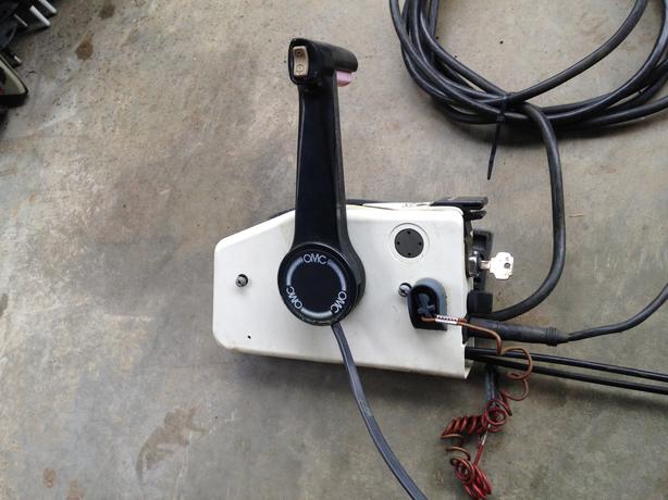

having to replace my starter switch ..got stuck for a few hours on the water cause it wouldnt work,but eventually it did..just made a bad day ..but anyway... while Im swapping it out, Ive wondered what these other two items do...or used to do.. #1 looks like its been ripped out or something missing (from previous owner) and #2 , its a knob...but whats it for?
btw..there seems to be no safety switch on this..Im assuming thats whats missing? Im not sure if I should just buy a new starter switch..or just buy a whole new throttle assembly. $20 or @ $200-$300 ? lol

Maybe 1 used to be a trim control?

I can't remember what #1 is but #2 is is used to adjust the tension of the throttle lever.

#1 was the warning horn, #2 is throttle tension, the other hole was the deadman.

awesome thankyou for clearing this up for me. guess there was no torpedo switch..now Im bummed lol thanks guys for the help. looks like I'll go the cheap route and just get a new switch..may be tradin this one in for a new boat soon anyway.
