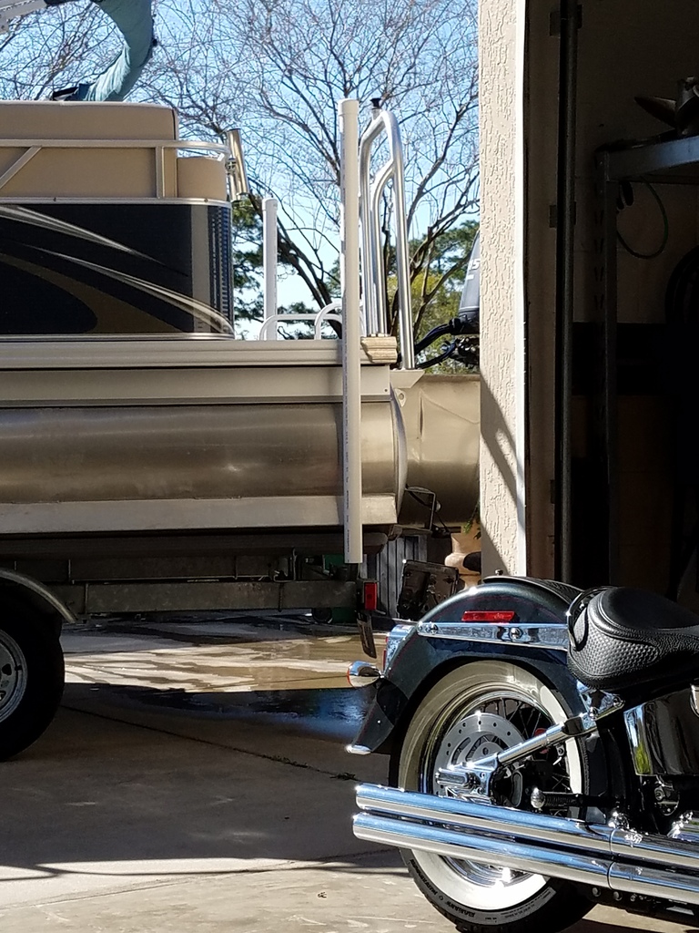

I used to have a hard time getting my 20ft Tritoon lined up on the trailer, especially on windy days. I bought some inner 2.5 foot guides and placed them on the inside of the bunks only to find the lifting strakes resting on them (2 foot above the trailer bunk) EEK! when I pulled the boat out of the water. Not good!!! I then used the same mounting hardware and bought some 5ft PVC poles from Lowes and placed them on the OUTSIDE of the pontoons. What a difference! I can now easily trailer the boat in any conditions. I am not concerned about the width because the poles are no farther out than the trailer's fenders. Here is a lousy pic of the poles on my boat. They are even, the pic just makes them look out of alignment. I highly recommend this if you are having problems keeping your boat straight while loading.
