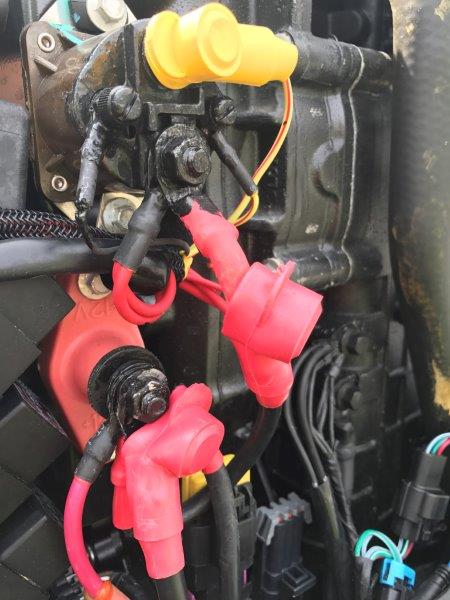

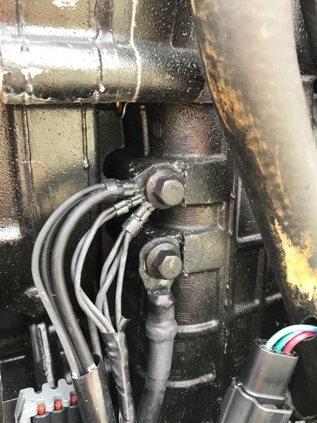

Yes, there's a single set of relays. One for trim up and one for down. What I don't get is that the trim works fine if the engine isn't running. So it's getting power from the battery fine. The engine starts fine. But when you use the trim when it's running, it's like it's draining everything from the engine causing it to stall. The volt meter does drop when trimming, but I can't believe it's enough to stall the engine. So in the picture. The power goes from the battery, to a positive stud. Then a cable from the stud up to the starter relay. The trim relays are the red wires connected to the power with the starter relay. The thick red wire on the positive stud comes from the alternator. All the connections and wires seem fine. The relays ground right by where the battery grounds. Those connections look fine too. I'm stumped!
The only thing....I think my trim motor is on the way out. I removed it and put new seals in the cylinder and replaced the fluid, but the motor just doesn't sound all that great. It's louder and just not as smooth sounding. It does try and stall more when trimming up. When going down, it's not quite as bad. Could a failing trim motor cause it to pull that much more power? The wires aren't that thick when compared to the starter. I'd think if it was pulling that much power I'd have melted wires. Now when I had the trim unit out and would test cycle it a few times, yes, the wires got warm. I don't really want to spend $800-$1000 on a new trim unit if I don't have to yet.

Well, I did some more testing. Didn't matter if you use the button on the remote or the motor. Disconnected the trim motor, tried the controls and nothing happened, motor kept running, so it's not a short in the switches. I reconnected everything and it seems when you hit the trim button, the engine hesitates for a second, but doesn't actually stall, it keeps running even if you keep on the button. So I guess it's ok.
