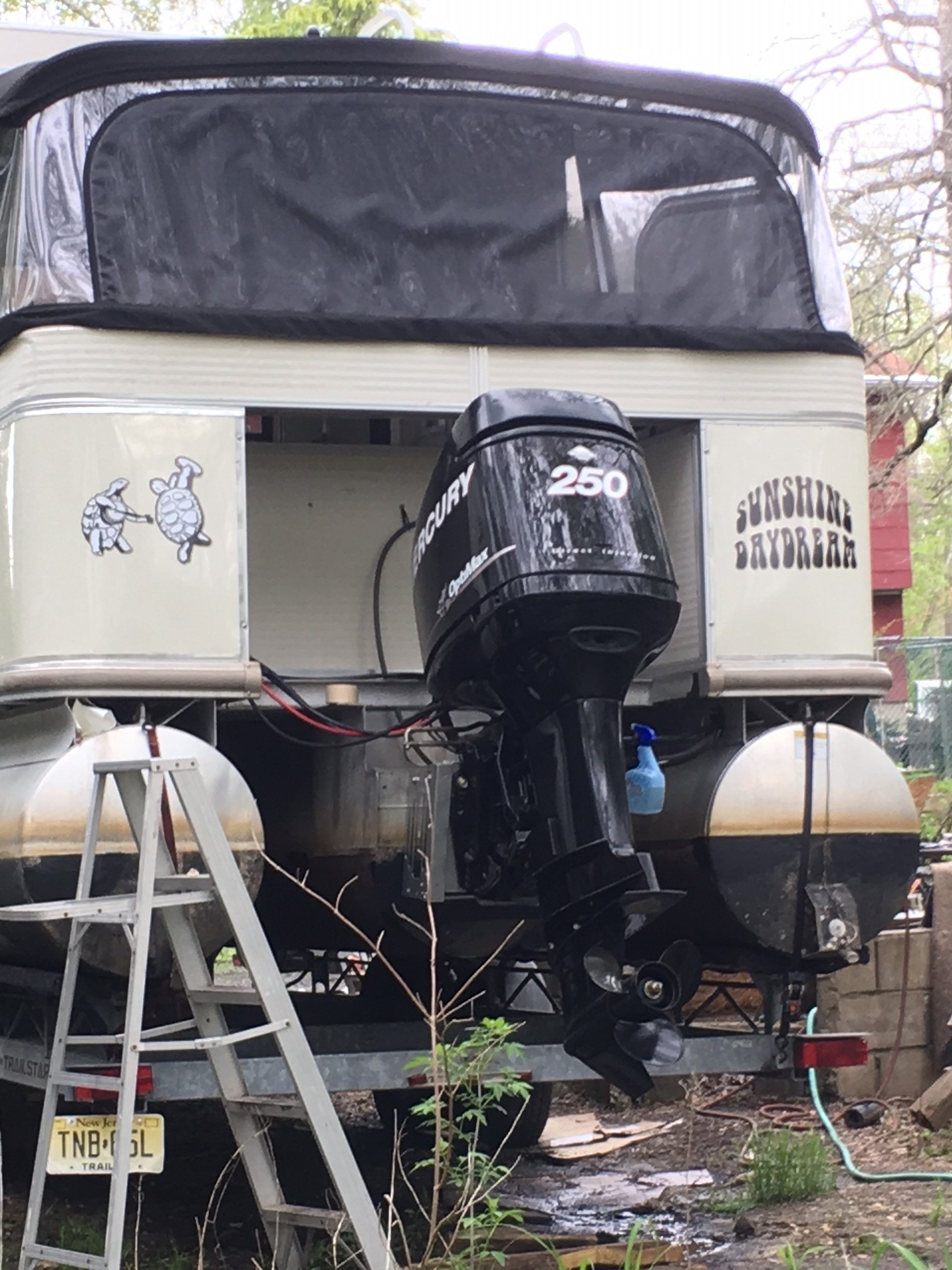

I have just installed a 250 optimax on my party cruiser,still breaking in the engine,i have not installed the strakes yet,but in a test run we already hit 22 mph,now currently installing underskinning,i beefed up the transom,added third toon,12 inch jack plate,were not looking to set speed records I wanted more power due to large bay we cruise with busy boat traffic and the sudden storms that we have encountered,
- IMG_0524;l.JPG (551.67 KiB) Viewed 7579 times
kenny...2005 32 ft party cruiser ,2005 silverado 6.0 4x4 what a long strange trip its been
