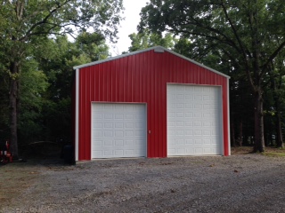

Re: Boat Barn Plans
Hello neighbor! We are on Bull Shoals in Oakland so you cannot be to far away.
I can't tell you what to build but I can tell you what I built and what fits. Our barn is 30wide x 40deep. It is on a poured concrete slab, has a 10x10 door, a 16h x 12w door and a mandoor. I have a 60 amp service. It is not insulated but I can heat it with a torpedo in winter when I am working. It does get warm in summer.
I have a 22ft tritoon, how ever when you add in the point of the trailer and the motor it actually takes up almost 30 ft. I put it in the side with the tall door and can fit with the bimini's fully upright. I park the zero turn and lawn vac behind the boat and just have room to walk around the front of the trailer. It pretty much takes up one entire side. During the season we keep it on a lift at the local marina so it is on in there from Nov. to April.
Hope this helps, see you on the lake!

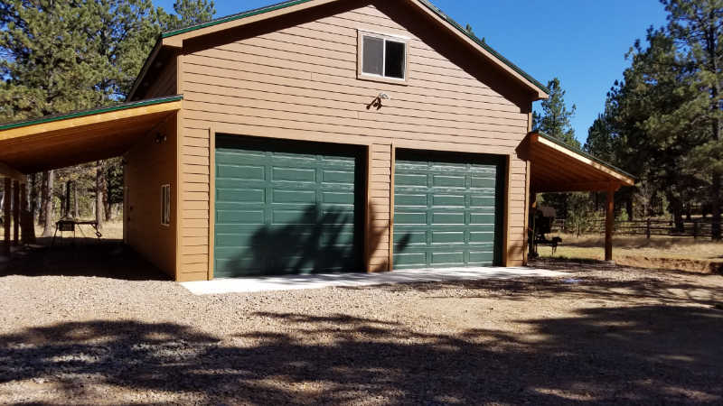

Re: Boat Barn Plans
my barn is 30 wide and 40 deep
my 24 foot pontoon on the trailer is just over 30 foot deep
with 12 foot wide doors she is easy to park inside or under the carports
minimum 12 foot high inside and build the biggest shop you can afford, you will never wish it was smaller
Also if you have the chance an attic truss is almost the same cost as a standard truss, you will get a free room upstairs
My cost to add the second floor was about 1600 total for 640 sf. course i built the thing myself so no labor involved..
