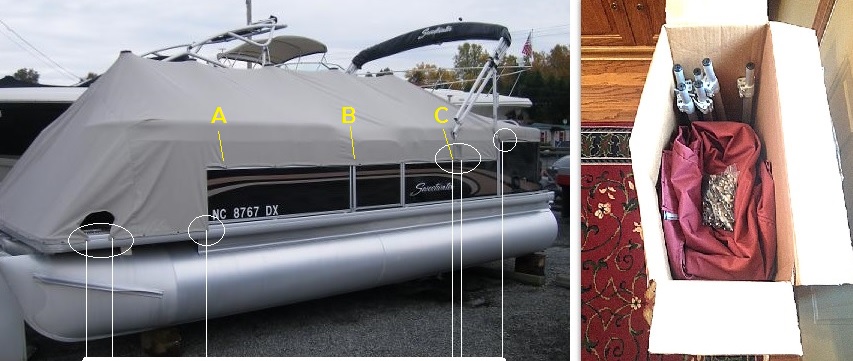

I have already installed the snaps in the areas that I consider "constants." The attached picture is not my boat, but it illustrates where I have installed snaps (white circles). These are the places, "corners" if you will, that can really only be installed in one place. This will be enough to hold the cover in place, with the poles installed loosely, while I mark the other exact snap locations. As I work my way around the boat, I will install snaps in the middle of the long stretches (B), say between snap A and snap C. I will do this on both sides until all the snaps are filled in.
Hope that all makes sense, I hope it works, and I hope it helps.
