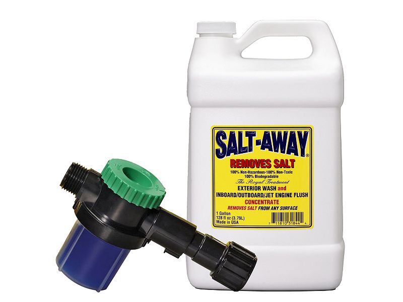

Extra measure of protection, used this stuff as long as it has been in existence, better than just a freshwater flush.
- saltaway.jpg (44.88 KiB) Viewed 10723 times
