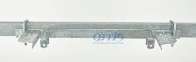

If your axle/s and springs are attached to these, they are called spring sliders or Bogy Beams, then you can move the axle/s aft to put more weight on the hitch as mentioned before if your springs are mounted to clevis's that are welded to the trailer frame you cannot move the axle. Pictures would help tremendously.
- spring slider.jpg (3.96 KiB) Viewed 14155 times

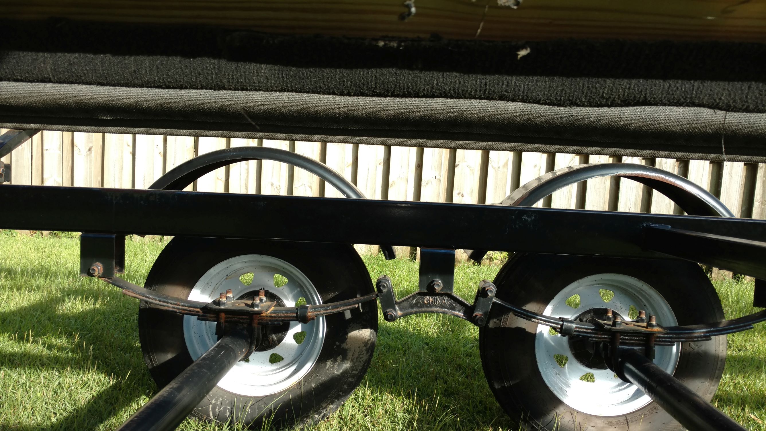

The spring brackets are welded to the frame and the axles are attached to the springs with ubolts. Balancing is gonna have to be via the stop.

Was this trailer built by the person who sold it to you, or was it simply a newish trailer he was selling privately?
Without seeing a full picture of the trailer I am at a loss to understand how a 24 foot trailer could be so out of whack that a 22 foot pontoon could have the tongue all but pop off the hitch unless the axles are way off base or your pontoons are full of water and you are dealing with a huge weight distribution problem...
