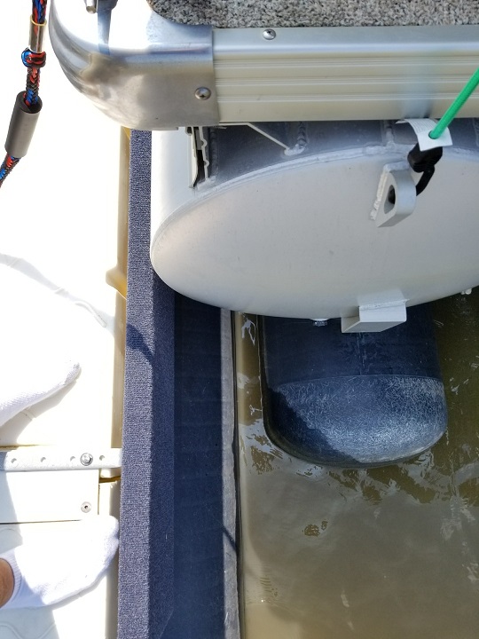

I'm thinking about taking my pontoon boat off of the bunk trailer and putting it on casters. Could I use four automotive engine hoists, one at each corner, hooked to the eyelets on the top of the pontoons? I could then roll the trailer out and carefully set the boat down on the casters.
Does this sound like it may work? I included a picture of the eyelets welded to my toons. They look strong.

When I had my pontoons bottom painted they lifted my pontoon from the same eyelets. Tried to post the picture but it's too big

They lifted both of my Manitou's from the eye's as pictured above. No problem...
