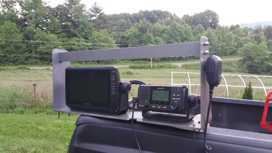

My plan:
I can build her box :P . I have the technology. I can make her better than she is. Better, stronger, faster.

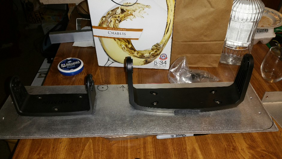

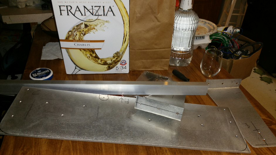

so I cut some alum out and mocked up what needed to be cut and rounded and bent (no way to weld alum. at home yet...so I made an erector set)
2018-05-28 15.11.01.jpg (153.17 KiB) Viewed 1814 times
2018-05-28 15.10.25.jpg (129.33 KiB) Viewed 1814 times

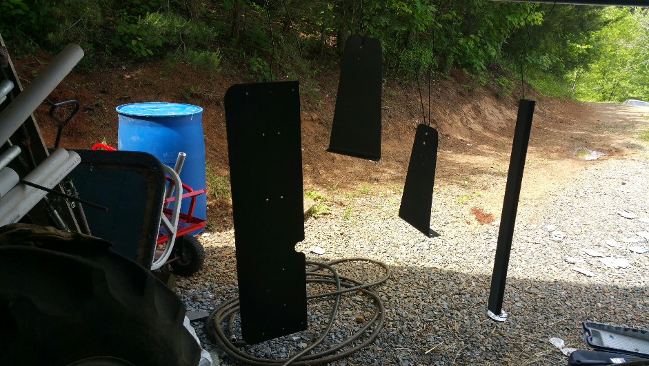

painting
2018-05-28 15.08.50.jpg (217.39 KiB) Viewed 1814 times

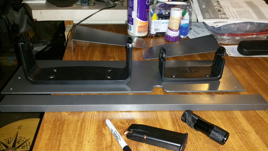

start to assemble
2018-05-28 15.09.28.jpg (148.06 KiB) Viewed 1814 times
I used 2" long 10-32 SHCS to bolt sides to bottom and to be used as locators (need to swap for SS bolts)
wires tied up and secured with quick disconnect plugs
2018-05-31 18.57.31.jpg (162.69 KiB) Viewed 1814 times
Here it is looking like an old skool tool box
2018-05-30 20.01.57.jpg (167.1 KiB) Viewed 1814 times

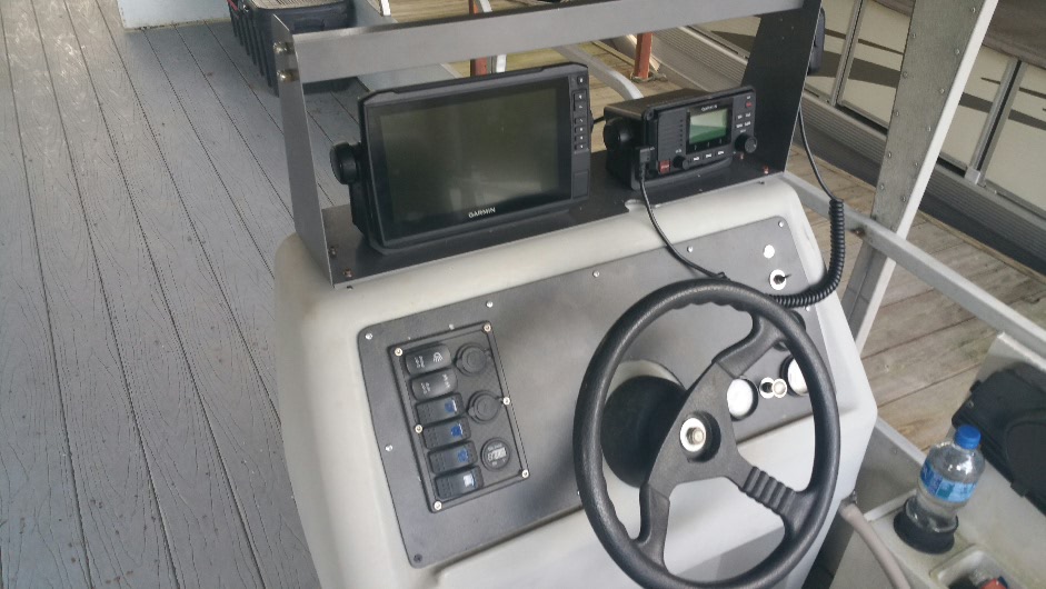

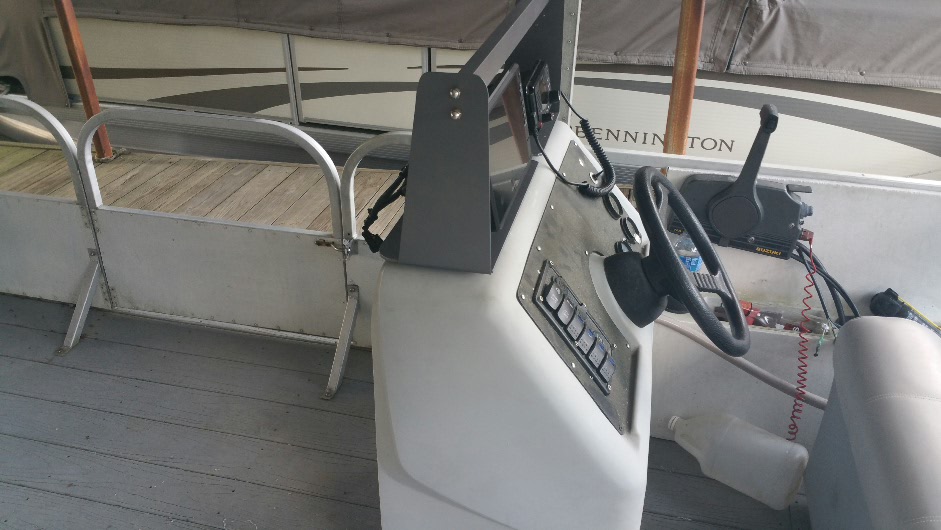

and sitting on console, I drilled 6 holes in the top for the bolts and 1 center hole for cords wires and the Quick disconnects are shoved in the cubby hole in a zip lock bag with an old kooz as camoflauge
2018-05-31 18.54.56.jpg (138.29 KiB) Viewed 1814 times
2018-05-31 18.55.19.jpg (112.81 KiB) Viewed 1814 times
everything looks crooked for some reason :donno
2018-05-31 18.55.48.jpg (121.38 KiB) Viewed 1814 times
it is not heavy, still need a couple latches to secure it, and finish the back cover and sun screen
hope it gives folks an idea or two
