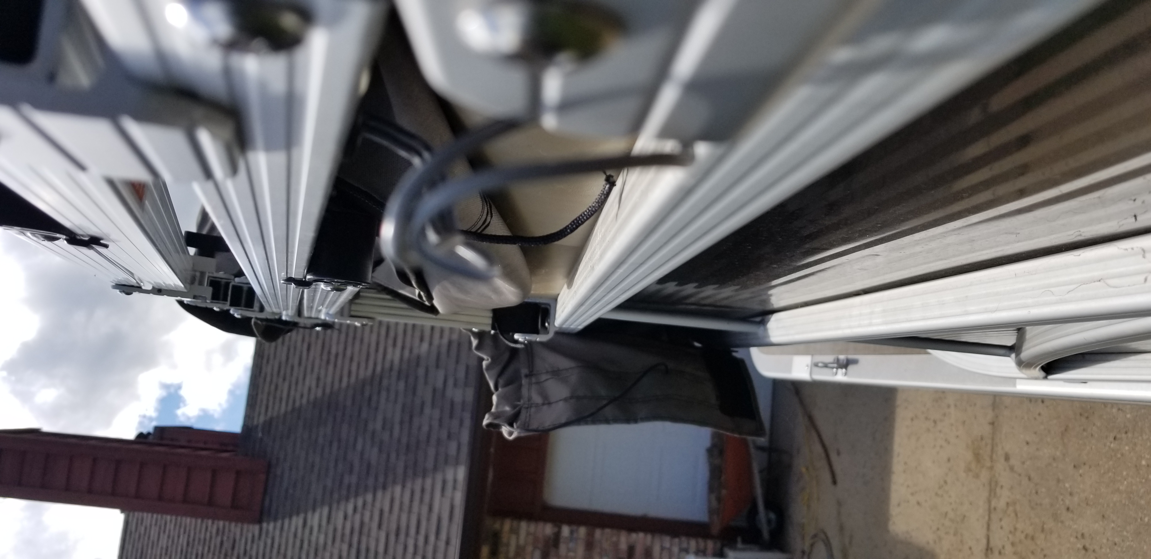

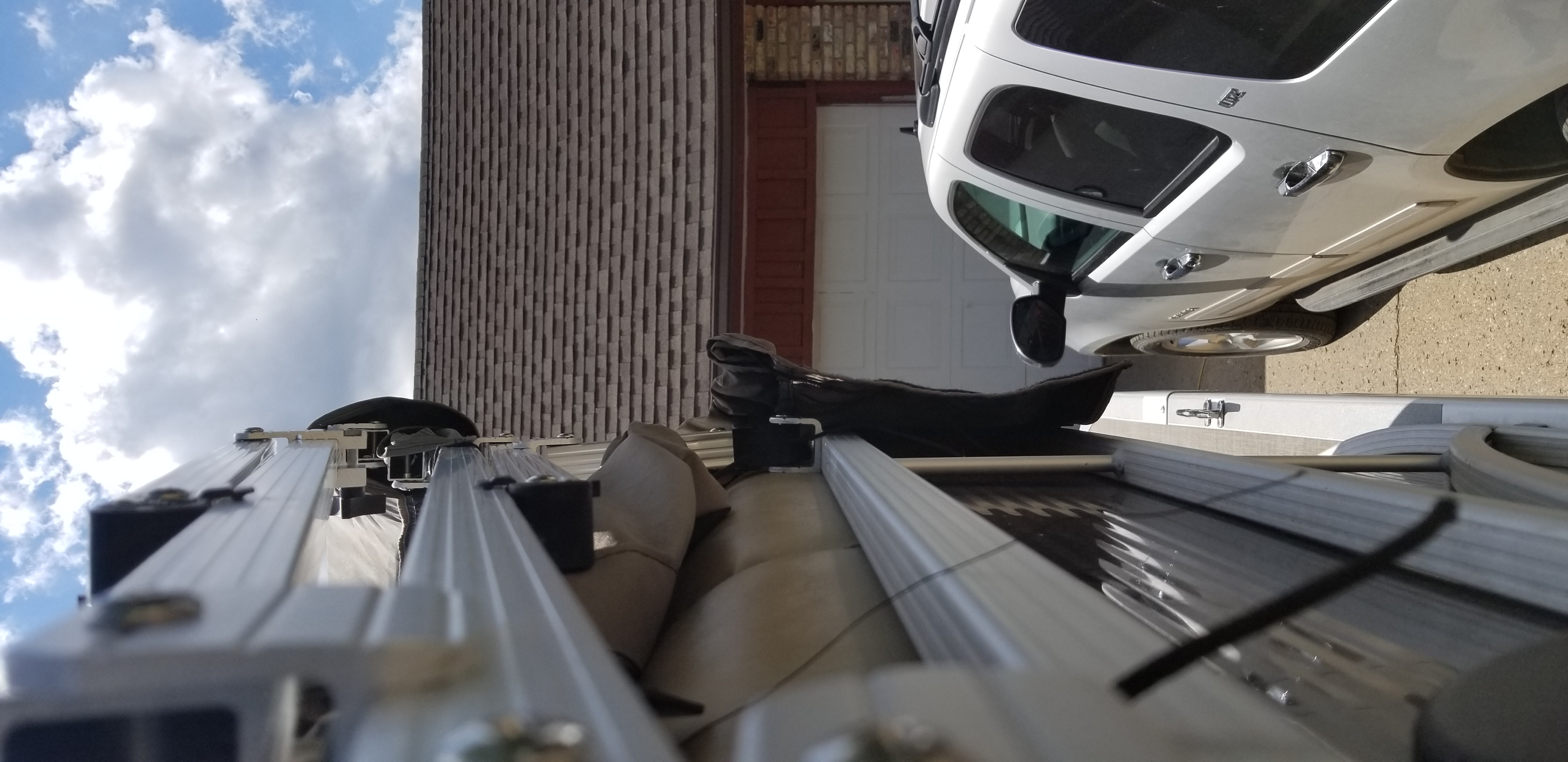

Re: Bimini top issues
Sorry it took so long also bad pics as cover is kn
- 20180626_161806.jpg (1.96 MiB) Viewed 7149 times
- 20180626_161716.jpg (1.96 MiB) Viewed 7149 times

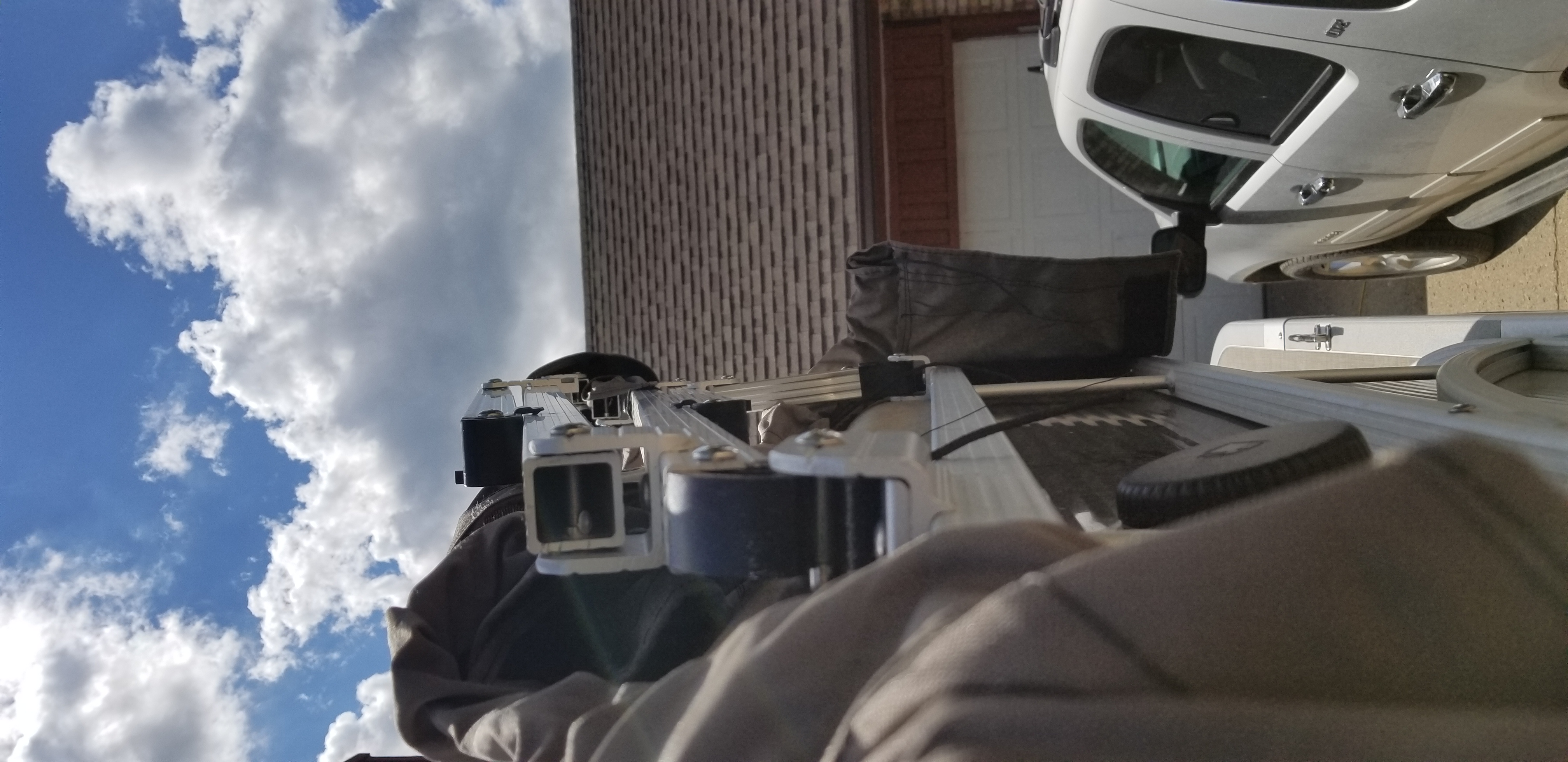

Other side
- 20180626_161942.jpg (1.87 MiB) Viewed 7149 times

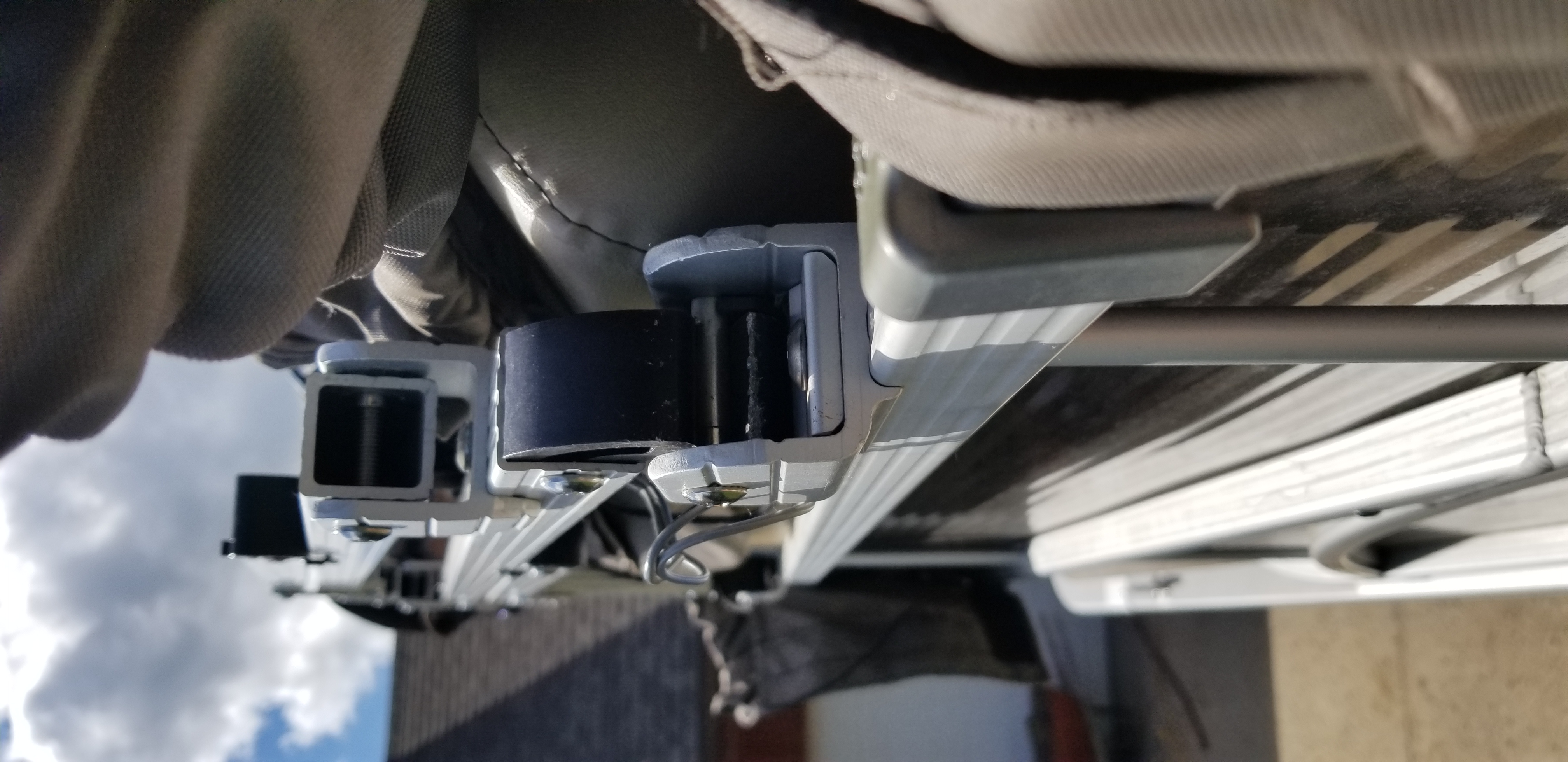

Dont know what to do
- 20180626_161928.jpg (1.81 MiB) Viewed 7149 times

Does this boil down to the top frame is wider than your fence width? I've noticed when shopping bimini top frames there's a lot of manufacturers with a "one size fits all" mentality where frames are formed wide enough to fit a 8.5' wide deck and to mount to a 8' deck you just flex the frame & stuff the ends in the brackets. Most ads for pontoon tops say it fits 88-102"--that's quite a range.
You can't tell when it's up but I'm not a fan of how it looks when the hoops are wider than the fence when stowed. On my rather old 'toon one side rests on the fence parallel on one side, with all the overhang on the other side.
I'm sorry if I'm mis-interpreting your post. The pictures look to me to be this issue. In any case it does look to be a very nice frame!

It appears to me that someone screwed up when measuring and drilling the railing for the bemini top. Instead of being straight across from one another one side is drilled a bit forward or backward from where it should of been. I'd loosen one of the side rail mounts and adjust it to where the bemini lays and looks right and mark and re-drill for the mounting bracket and hopefully the bracket will cover up the bad one.

From what you say about pushing the struts out for the top to fit in the brackets and the pictures show, it looks like a top could be made a few inches wider a lot easier than moving the fencing.
