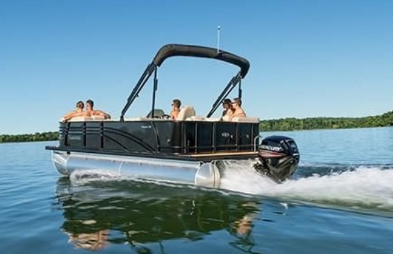

I have a new 2019 Harris Sunliner 220 with a 150 hp Mercury. Today was only my second time out on the boat and I had a couple of friends with me. One of them was looking all around the boat and made his way to the engine. He had the other guy drive while I went back to see something that concerned him. He pointed out water flowing in large quantities over the fuel tank which sits just in front of the motor. The water was flowing over the tank then exiting thru the drain holes in the transom. Is that normal? Also, the fuel pump electrical cable was sitting in the middle of all the water flow with a connection exposed to the water. Just want to be sure that is ok as well.

I found this stock photo online. It appears to show what you're talking about, but I can't be sure.

Thanks for the replies. I have sent a message to Harris via their website, don’t expect a reply until tomorrow (Tuesday), so I will post their answer here. That picture looks like what I saw, but it does seem like a strange design.

I just purchased almost the same boat, full middle pontoon with a 200, Guess I need to go out and look at mine, but I see lots of pontoon boats with the same picture as above, water just pouring out the back of the boat. :donno

Its normal for a ton of water to flow out between the pontoons, it has to go somewhere. I think the OP was worried about the gas tank get splashed with water. I certainly can see that being a concern, but if the gaskets are fine all is good.
