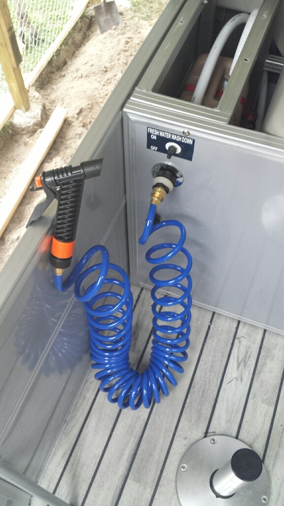

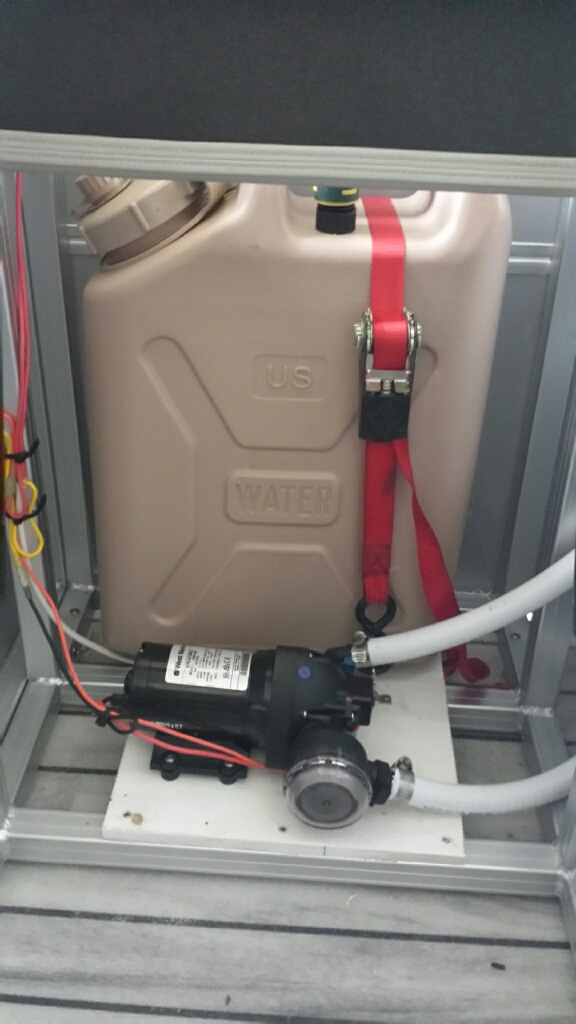

Many bay and off shore boats have as standard wash down pumps. On those glass boats they pick up in the same manner as bait wells do usually on the bottom of the hull. This is not conducive to the aluminum hulls of pontoons however, it could be mounted on the stern of the pontoon as are depth sounders OR it could be portable on placed in the water as with the power washer described earlier.
I have used these most of my life for washing down the decks after fishing all day. They can be found at most marine sites or stores. They are handy as all you need to do is flick a switch and the 12 volts from the boat powers the pump. Or if you have shore power you could just hook a pump to the dock and leave it hooked up with a hose. A 12 volt power source could also be used with a 12 volt pump. There are a lot of options depending on how far you want to go in installing and the set up you have at your site...
