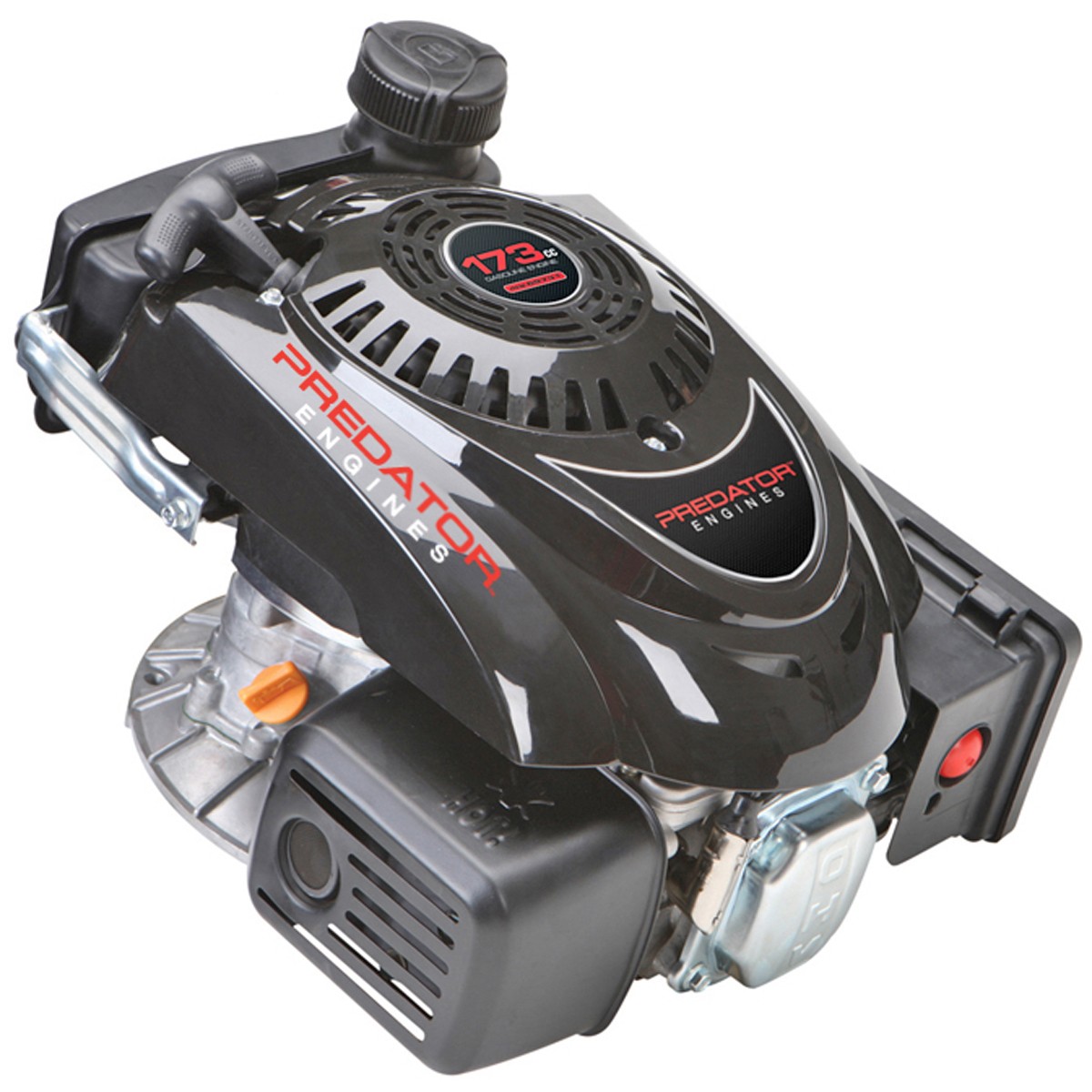

1. Harbor Freight Predator 5.5 hp 4 stroke vertical engine - the kind used on riding lawn mowers. ($125.00) The output shaft will be facing down toward the water.
hf engine.jpg (186.72 KiB) Viewed 20564 times

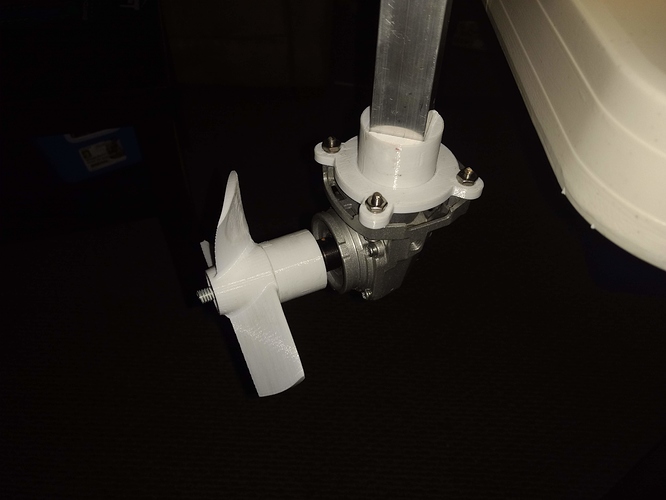

torque tube.jpeg (82.23 KiB) Viewed 20557 times

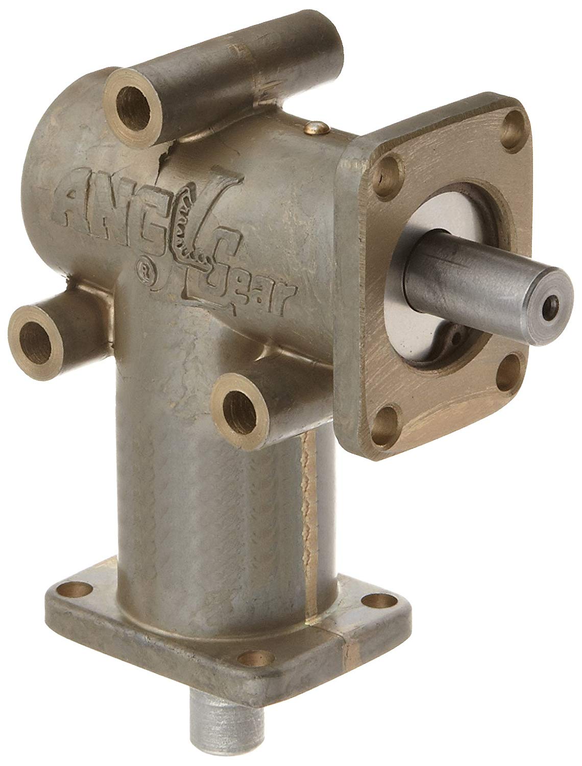

NOW I'm getting somewhere. This right angle gearbox is rated to handle 11hp at 1750 rpm... for $70.00. I'm liking this project now. I'm into $200.00 so far the motor and gearbox.

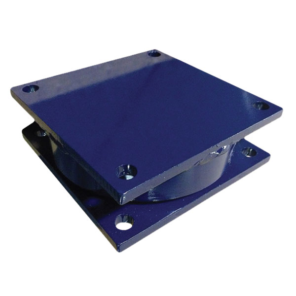

Thanks, those look good but I'm going to need something heavy duty, basically I've got a lever that is going to try to pop the two pieces apart. A serious unit like this would probably work, and it can be ordered with a 1" hole in the center - perfect for my drive shaft. This bad boy can accommodate 1500 lbs. and weighs 11 lbs. I'll need to fabricate a stout plate to mount this to so that I can spread the load over a greater surface area on the plywood.
