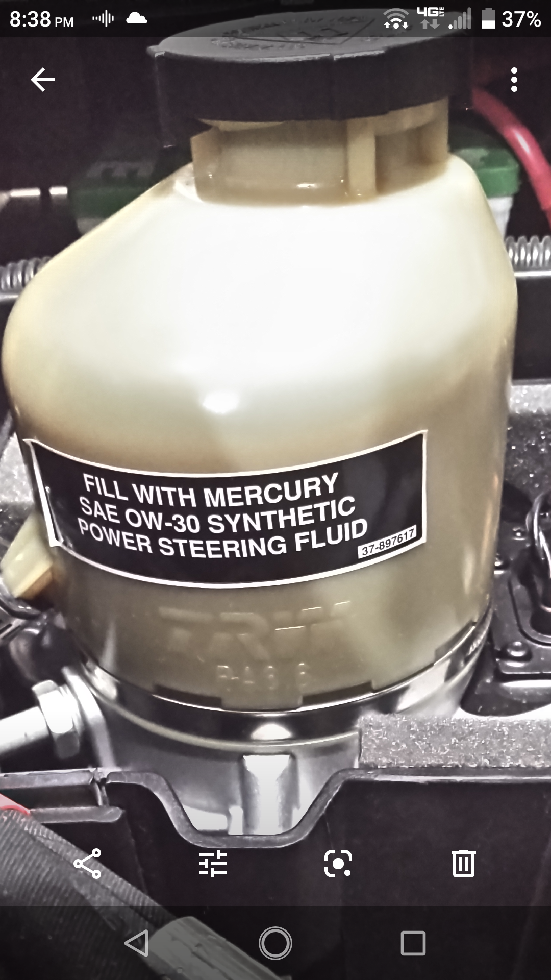

#6 Post by Liquid Asset » Mon Jun 15, 2020 5:41 pm
This is what my verado steering pump says right on it!

#7 Post by Horsepen » Mon Jun 22, 2020 1:32 pm
LA, looks like yours is Mercury’s power steering. I think he is referring to a Sea Star hydraulic steering, not an engine or externally powered system like yours. And to the OP, off hand I don’t remember the mil spec number for the Sea Star brand of fluid, but it should be on Sea Star’s website. Any hydraulic fluid/oil with that same mil spec number will work just fine. Sea Star also says that in a pinch one can use automotive power steering fluid and many people do. I have not. I use fluid that carries that mil spec number.

#8 Post by Liquid Asset » Wed Jun 24, 2020 4:13 pm
I know most verados came standard with the mercury power assist, and with a quick silver ( mercury) part number mentioned i assumed it was what he had. I have heard of some verados without it but thought it only the 135 HP. Sea star is made by teleflex and probably wouldn't have a quick silver part number.
