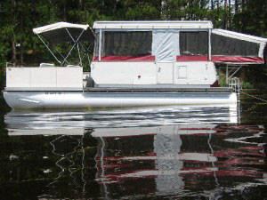

I've seen that picture, but thanks. Anyone can plop a camper on top of a flatbed... keeping the wheels on and able to load/unload at will is the trick. I want my process to be literally push button - and that's why I've got two winches now sitting in my garage.jim454 wrote:here's the website, http://www.romppais.com/pontoon%20boat%20kits.htm
Something interesting to note in that picture is how incredibly unbalanced that boat is - WAY too much weight aft to my eye.

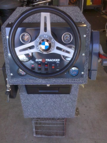

Gentelmen, we have a new console
Probably the hardest part of the project. DONE!
Go here for more pix: http://picasaweb.google.com/MillerRonK/ ... OX_qpS1qwE#
About $100.00 worth of stuff to build new. 95% of what you see is salvaged, reconditioned, painted or cleaned. The BMW logo: Priceless.

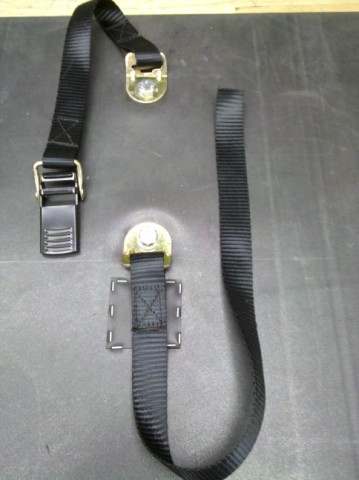

New floor and tie downs for bat compartment
1/2" Meranti 9 ply floor covered with seamless thick EPDM rubber to protect against any future acid spills. 1,000 lb. test nylon straps, Grade 8 brackets, bolts with nylon lock nuts. Kev-Lok brand locking cam is what you might expect to see in an airliner. Not shown is the salvaged battery box which is very thick plastic and much better quality than what you can buy today.
I think the new battery will be secure.
The new 29 gallon fuel tank is going to get the same treatment.
While this is TOTAL overkill it's what I had on hand.

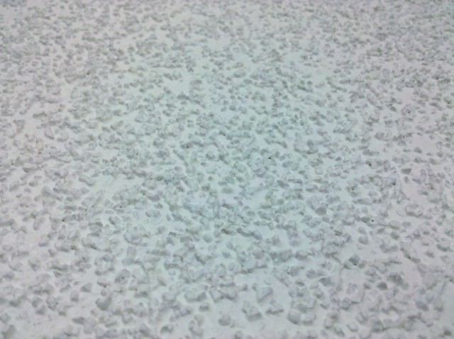

decking with crushed walnut shells
SERIOUS traction for pushing the trailer if needed. Nothing more frustrating than trying to push a heavy object and slipping.
The top coating is now 5 layers or 50 mil thick, a standard credit card is 30 mil.
If I was going to coat a standard deck I would use 1/4 the volume of shells.

Looks like it's to be towed by another boat too.RonKMiller wrote:I've seen that picture, but thanks. Anyone can plop a camper on top of a flatbed... keeping the wheels on and able to load/unload at will is the trick. I want my process to be literally push button - and that's why I've got two winches now sitting in my garage.jim454 wrote:here's the website, http://www.romppais.com/pontoon%20boat%20kits.htm
Something interesting to note in that picture is how incredibly unbalanced that boat is - WAY too much weight aft to my eye.That camper needs to be centered more.
