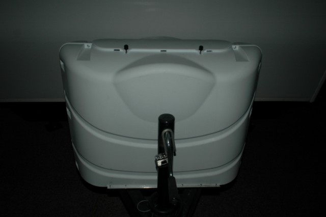

goldnrod24 wrote:The "hitch" area seems like a lot of wasted space. Could you figure out how to use that infrastructure to mount the table? It would give you more deck space.
Got any elevation sketches so those of us without vivid imaginations can get the picture?

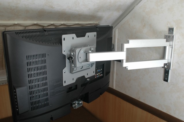

That's an excellent observation - and one I too thought of after finishing my sketch. The top of the round vertical tube for the hitch jack would be a PERFECT place to mount a table - and at a good height too. I'll probably go with a standard plastic oval top. I may go to the trouble of having a custom two level triangular one built - I have a feeling more table top space is always a good idea.
The 32" HDTV will mount right above it. It also fits inside on the wall at the bottom of the queen bed - same articulating arm. We love watching old, classic movies on a warm night with pop corn - of course!

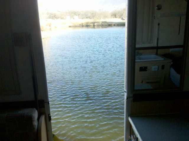

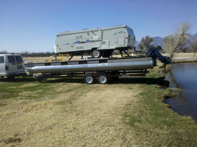

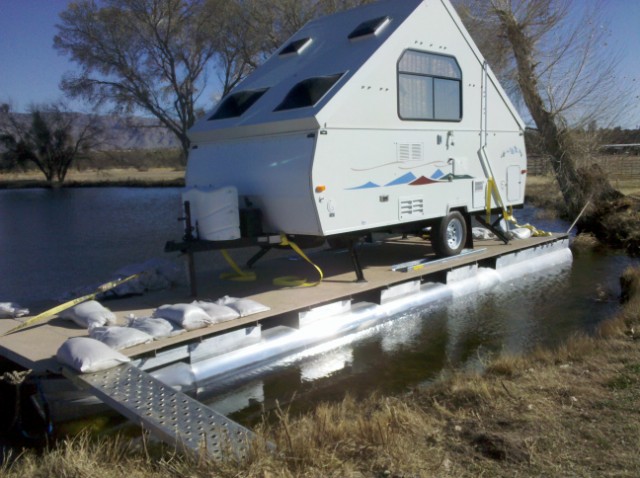

#137 Post by RonKMiller » Fri Feb 11, 2011 5:51 pm
Proof of concept, still LOTS of work to do. This is with MAX loading - note the sand bags. Simulated are full gas, propane, batteries, water, food, furniture, railings, roofs, helm, 4 passengers, BEER - the works. Enough provisions for 1 week and 200 miles without visiting a marina.
Of course this is only a 1 acre pond. :happy
The tie downs are only temporary ,OK? - until the locking wheel clamps, winch cable, etc. are installed - so don't ask. :shock:
A pretty good view from my front door... :nana

Ron,
Not meaning to rain on your parade, but when you remove all the sandbags in the front that's representing people and redistribute the weight into the camper itself. I can't help but believe that is when your weight distribution on the boat is going to become somewhat of an issue. Or is everyone going to sleep out on the deck :roll: .

#141 Post by RonKMiller » Sat Feb 12, 2011 9:21 am
Bamby wrote:Ron,
The current simulation with the sand bags represents the weight distribution when under way plus 800 lbs to max capacity. It includes all 4 passengers, furniture, helm, railing, table, permanent roof, etc. It is currently level. I have to assume that when under power there will be a slight - very slight - nose up pitch, which is what I want.
When at rest at night, the only re-distribution will be the 2 passengers moving behind the axle of the trailer to sleep in the queen bed - which will result in only a few degrees change in pitch - since that's where the third toon is - it's really "half a toon". If I have an additional 2 passengers with me, they will sleep outside on the front deck or on the beach. If only one passenger there is a nice sized sun deck pad on the back deck not yet installed. This bad boy is 28 feet long overall, but there's only 8.5 feet available up front.
Ain't no way they're coming inside with me and ma. :nono (unless it's raining) 95% of the time this will be a 2 person rig.

#149 Post by RonKMiller » Fri Mar 11, 2011 9:51 pm
It's been in the water now for a month and came out today - no leaks! :nana
Went to the dump during rush hour for total weight including travel trailer, boat, hauling trailer: 6,940lbs. Had a deputy sheriff tailing me the entire way at 15 mph (as fast as I could go through the tight cones) through a 25 mph, two mile long construction zone. I'll be he was gnashing his teeth trying to come with an idea for a citation. :eviltaunt
Keep in mind this project is about half way done - still a LOT of work to do. Back to the barn for a couple of months. The next time it's in water will be for trials and coast guard certification.
