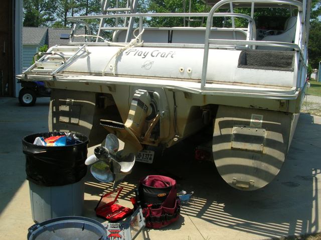

My Playcraft barge is not a big block, but I enjoy the decent performance and she is kinda easy on gas. We don't run that fast, but the lack of range vs time restricts our travels at times. Plus, its a two pontoon boat with the I/O in a fiberglass pod that drags thru the water like crazy...not one of PC s best designs. Here is a shot of the ass end...

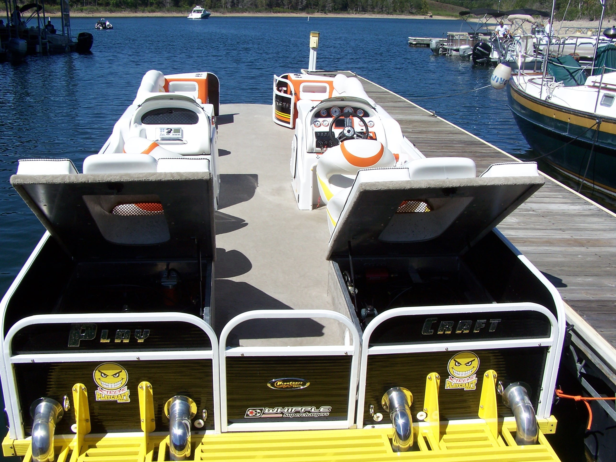

Dual Whipple Supercharged 30' long x 9' wide Playcraft I/O
