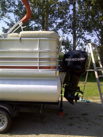

On the way home from work on Friday I stopped by a local store calld Fleet Farm, they sell a lot of stuff, so I picked up some 4" x 3/8" grade 5 bolts and nuts and enough grade 8 flat and lock washers to bolt it in place. Also while I was there I passed the Krylon display and they had a color called 'Aluminum', so I spent another $11 ($5.50 for each can, 1 "aluminum" and 1 white "primer/sealer") When I got home, I used some 80 grit dual Action sander discs to sand it down by hand, then wiped it down with mineral spirits and started spraying on the primer. I let that 'flash' for about 15-20 minutes and then started applying the 'aluminum' color. That paint is a bit weird, it seemed like it was spraying metal flake, just the pattern it made and the immediate appearance like tiny wet metal flakes sticking to the primer (of course this was my second can of spray paint inside a building with inadequate ventilation :roll: )
But here is the final product. I ended up using 2 bolts per mounting plate, all 8 bolts are passing through 2"x2" aluminum deck bracing. And the tow hook ring is drilled/bolted intot he center. I hope to try it out tomorrow, results to follow..
Finished product about to be bolted into place
First look as I stepped back to view my handy work..
From the side, you can appreciate the 'lean' toward the rear and see how high it is compared to the sun deck, it should give me great visibility to what the rope is doing..
And a final shot right up the backside..
