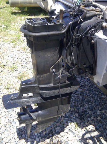

No compression on #1
Rough Idle (no doubt due to the compression issue)
Crystal Pierz cannot get into the computer to read any diagnostic information
He stated that on these motors if a Direct Injector fails they will present as no compression and asks if they have had a bore scope down the hole to check for scarring/scoring (they had not)
According to him 530hrs on an Optimax is 'low hours' he typically does not see any real problems with them until they are above 2000hrs (good news to my ears) during our chat he also lets me know that he thinks the prop I just bought (Quicksilver 13.75 x 15p) is too much and that it will slow down the motor too much. And then he tells me to go get my boat from CP and bring it to him. He has many spare parts (new/rebuilt) and can get me back on the water faster.
I left work 15 minutes later and got my boat and took it over to his shop, CP did not charge me anything for their 'work'. Its not that I think CP wouldn't have done a good job eventually, its that I want to get my new purchase back on the water now (or as soon as possible) and CP is backed up, they only have 2 techinicians and normally they have 2 service writers but one is on vacation this week, and as they said they were trying to squeeze me in before the weekend. As Pat from Kovash told me, when you call here you will always talk to the mechanic, he won't give me any service writer run around.
I must say, pulling a 24ft pontoon through town during rush hour and through traffic when it is 87°f and being surrounded by idiot drivers who continously cut me off was NOT my idea of a good time. At one point I had to lock up the brakes to keep from hitting some a$$pony that cut me off as a light turned red, I swear small car drivers have NO concept of how much space a truck and trailer require to safely stop, I leave a safe distance between me and the car ahead, some Id10t would pull into it...
So I finally get to Kovash, they closed 20 minutes earlier but the mechanics are still working on boats (4 or 5 of them) the owner Pat has gone home for the day, I really wish I would have gotten the mechanics name that I talked to that did my service order write up, he as a friendly guy (showed me the bore scope, which looks just like endoscopy equipment but less sterile) I counted no less than 6 rebuilt and ready to install 90hp Mercury Optimax motors/drives hanging on their racks ready to go. I also found out that if I want a 115, the only things I need to change is the ECM and remove an air restricter the powerhead/fuelsystem/everything else is the same (they offered to do for me if I so chose...25 more HP I will get prices after I get my current motor sorted)
It turns out that this shop pretty much only works on motors/drives. According to the mechanic I was talking to, this winter all of their bays were filled with rebuilt motors. All winter long they buy motors, repair the ones that can be saved and scavenge from those that cannot. Then come Spring they have a very nice inventory of used/rebuilt motors to sell. I think I am going to like these guys, I have a motor problem and all they work on is motors, I wish I had known about them when this mess started...
I am still not slighted toward Crystal Pierz, I think they are just too busy and I am too impatient.
Just got off the phone with Pat (Kovash) the #1 piston is garbage, he is working up prices for installing a replacement powerhead and he says I will be back on the lake by next Friday (which sort of stinks but at least he gave me a timeline and he has only had the boat in for inspection since 8am this morning it is currently 9:40a CST)
He said that he has a 'like new' powerhead that was on a boat that caught fire, he is going to do some figuring on what is a reasonable price, I let him know that his competitor (NOS Marine) told me $1200-$1500 (plus refundable core $800) and that Crystal Pierz had quoted me $3400 for a Mercury Quicksilver replacement. He stated that the CP part installed would run up to about $5k, and he would most likely be under $3k for his (parts and labor)

I got a call from Kovash Marine yesterday (6/11) morning, the cause of the failure.. water in the 2 cycle tank. According to them, there is a seal that keeps rainwater out of the engine cover and another that keeps it out of the 2 cycle tank. They said mine had failed (the seal) and that let water accumulate in the 2 cycle oil tank and when the 2 cycle pump tried to lubricate the cyclinders with water instead of oil, well things just didn't work out long term.

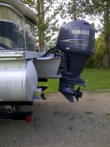

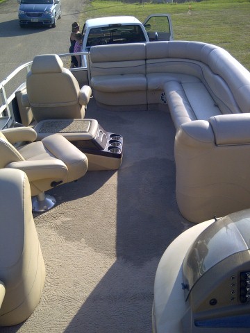

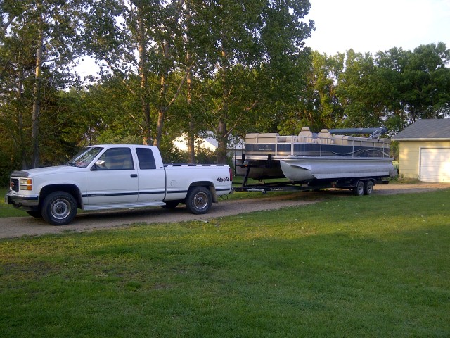

I should also let you know that last weekend (it was hot here 90°f+) the dealership did give us a loaner, a 2008 Bennington 2574RLI
I don't know if it was because of the super strong wind, the extra girth (3ft longer, heavier engine, heavier trailer, etc) or because we ran the AC all day on high, but pulling this thing dropped my gas mileage from 12mpg (when pulling my 2007 South Bay 922CR with the 18yr old 3/4t GMC shown in the pic) to a paultry 7mpg.. I could watch fuel guage move, it made my butt hurt, right around my wallet area....
I had hopes of high speed cruising with this 'toon. Large tubes, lifting strakes inside and out, The Yamaha 150 4 stroke was running a Solex 15x15 aluminum prop. But it did not perform as I had hoped/expected. We heard a lof of what must be cavitation coming from the prop when trying to get 'up to speed', we couldn't give it full throttle from full stop, most of the time when we were up to speed around 2k RPM we still couldn't go full throttle, we had to ease into it, otherwise it sounded like the prop was churning and making froth... I don't know if the following was because of the lifting strakes on the outside of the tubes, or just a normal behaviour of a longer 'toon. But when you would try to corner hard at all, it would lose all forward momentum and cavitate like crazy, no sirens or alerts went off that the motor was overrevving (I had that happen a few times with my SouthBay Optimax when we went over large swells) but if you didn't pull back the throttle it wouldn't bite again. Another thing I thought was weird was that the inner lifting strakes did not extend all the way to the rear of the tubes, but the outer strakes did. Since I have never been on a 'toon with strakes I had expected to 'feel' it lift out of the water when it got up to speed and that just never happened, when I looked over the sides of the 'toon at max throttle (wife was driving) greater than 2/3 (more like 3/4) of the tubes were in the water and I couldn't even see the lifting strakes at the front of the tubes (I assumed that they would be visible if the 'toon was up on them) We didn't have a GPS with us on this trip so I don't know what speed we were actually going, it felt like a good speed... when we were full throttle you could see the top of the cavitation plate just below the water spray indicating good engine depth, but I really felt like the Prop was letting us down. The engine was whisper quiet compared to the Optimax. The 'toon had a lot of nice features like changing room and the extra 'captains' seats in the front.
This model does have a collapsable tube pulling pole that retracts into the sun deck, but we didn't have a tube with us (we left it on our boat that is getting repaired.
Aside from what I percieve to be the need for prop tuning, the only other issues that we noticed was that when we were on the water, whenever a wave would hit the floor under the second (rear most) of the 2 captains seats, you could see water coming up from the bottom. I assume that this is almost a 'natural' downfall of having the wood seams directly above a brace and that the waves against the brace forces the water through the crack. At first I thought one of the kids had spilled their juicebox (clear liquid non-staining color) but then I watched it for a while, you can see in a couple of the pictures the wet spot on the floor. And the down braces on the ladder need to be rewelded.
I won't be asking for it, but I think that this pontoon on smoother water (it was really really windy Saturday 6/9) with a tube would have been a blast and I honestly think that my let down on performance was probably just me being sour about using a loaner rather than the boat I am paying for (but I am still happy that we got onto the water!) Pictures with water in the background were taken at Pelican Lake, MN.

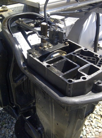

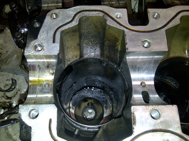

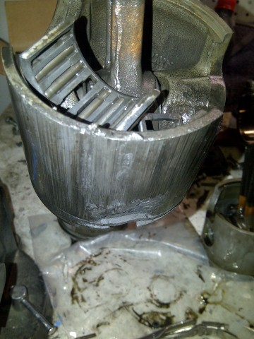

Back from getting my tube/ski bar bent and visiting the 'toon over at Kovash..
Poor 'toon is in impound
And (power)headless... :(

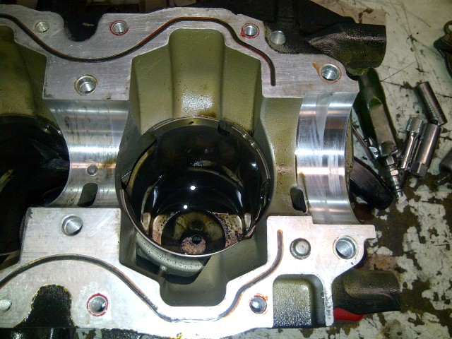

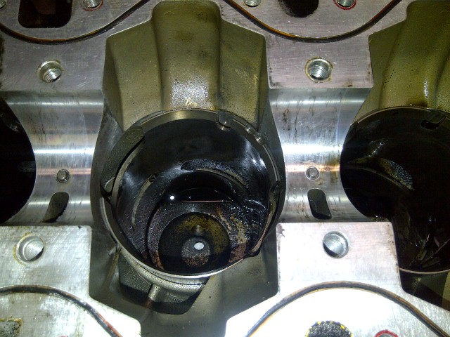

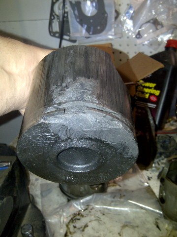

The mechanic showed me the motor
#1 Piston.. is junk
The #1 cylinder has evidence of pounding piston and ring parts into the combustion chamber
#2 looks better
and #3 looks 'good'
Unfortunately now instead of being able to be done this Friday, he is telling me that Monday is the best bet for getting it back.. probably because I didn't tell him to go for it early yesterday, other customers 'snuck' in there.. and he offers 90day warranty on all his work (limited to the components that he rebuilds/replaces)

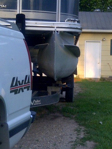

A question that I have been wondering about the underskinning is, why always aluminum/metal? I understand that it is tough enough to take the beating, and a lot of people like it because it adds a second 'surface' to the deck supports, but what if all I really want is reduced splash and to get rid of the braking affect caused by the splashing? Yesterday, I was talking with one of our assembly workers yesterday and he was mentioning to me a thick plastic/rubber sheeting that is used on the floors of semi trailers to assist with sliding out heavy objects. It would be much thicker than aluminum but he said that they did a 8ft x 53 ft dry van and the rolled up sheet was light enough for 2 guys to carry. Then I would use some sort of re-enforcement, either long strips that run from front to rear (perimeter and a few in the middle) or across the braces (width wise) I am going to follow up with the engineer that spec'd that material to see if he can get me any additional information about it (strength/name)
I take pictures of almost everything that I do, mostly because I suffer from CRS, but I have found that just because you are 'done' with a project that doesn't mean you paid attention to everything..
-ron
Mercury 90hp Optimax

ronb wrote:...A question that I have been wondering about the underskinning is, why always aluminum/metal? I understand that it is tough enough to take the beating, and a lot of people like it because it adds a second 'surface' to the deck supports, but what if all I really want is reduced splash and to get rid of the braking affect caused by the splashing? Yesterday, I was talking with one of our assembly workers yesterday and he was mentioning to me a thick plastic/rubber sheeting that is used on the floors of semi trailers to assist with sliding out heavy objects. It would be much thicker than aluminum but he said that they did a 8ft x 53 ft dry van and the rolled up sheet was light enough for 2 guys to carry. Then I would use some sort of re-enforcement, either long strips that run from front to rear (perimeter and a few in the middle) or across the braces (width wise) I am going to follow up with the engineer that spec'd that material to see if he can get me any additional information about it (strength/name)...
It may be UHMW (Ultra-high Molecular Weight) plastic. I've never seen a boat underskinned with it and don't know the benefits/drawbacks, but they use the stuff for skid plates on off-road vehicles, so it's definitely made to take a beating. I'd be interested to hear if anybody has ever tried it and what the results were.
