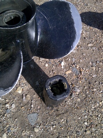

well since you asked.. I will give you the play by play on the steps when I changed out my 14x13p (max 5800 RPM) to a QuickSilver BlackMax 13.75 x 15p (max 5400 RPM) prop recently...
Here is my original (to me) prop, I wanted to try another size and everybody should have a spare (or 2)
I bent out these tabs to release the lock ring
wedged a prybar between the prop 'fin' and the down drive (gearbox) so it didn't spin and removed this nylock nut
Next came off the locking washer itself
and finally this insert that appears to be the key component that fits the splines, fits inside the rubber bushing inside the prop and holds the whole thing together. (it must have a real name, but I don't know it right now) my guess is this should be the only Yamaha specific part that you would have to worry about, getting the right spline size/count/diameter.
The empty shaft, awaiting the new prop
The old and new props side by side
here you can see where you need to push the rubber insert out of the old prop (I used a small pry bar)
And finally the insert next to the original prop
pop that rubber insert into the new prop and re-assemble in reverse order...(which I also have pictures of, but I'll save you the bandwidth..)
