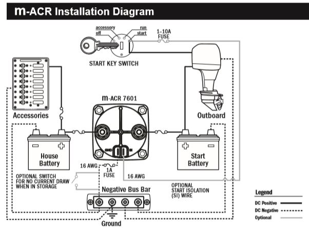

what is the purpose of the start isolation circuit, I see that bob did not do it, is it an optional step like the led indicator.
Also would it be correct to just jumper the (-) on the batteries together and run the house and motor battery (-) off one battery as long as they are bonded just to simplify the wiring with less connections. I noticed the drawing from blue sea does not even show (-) for the house circuit.

This may be a better drawing showing the (-) for the house circuit.
http://assets.bluesea.com/files/resourc ... 310020.pdf

I'm going to resurrect this post from the dead instead of starting a new one.
I'm thinking about adding another battery and adding the Blue Sea M-ACR, my question is do I have to or has anyone NOT installed the Battery switch along with the M-ACR. Is the switch just for a backup if you would need to combine both batteries? I'd like to just keep it a little simpler and not use the battery switch.
Looking at 1 of the diagrams Blue Sea shows on the instruction (below) it looks like it should be fine, just would like to be sure.
Thanks guys.

#24 Post by onlybillhere » Thu Jun 18, 2020 9:56 am
I installed a VSR (voltage sensing relay) just like the one from Blue Seas without a switch. I also wired it where it only activates when it senses the voltage over 13 volts ( when charging by the motor) and not used the ignition. It has been this way for about a year now and no issues.
My batteries are rarely ever ran down so I don't worry about my motor having enough current to charge them both.
