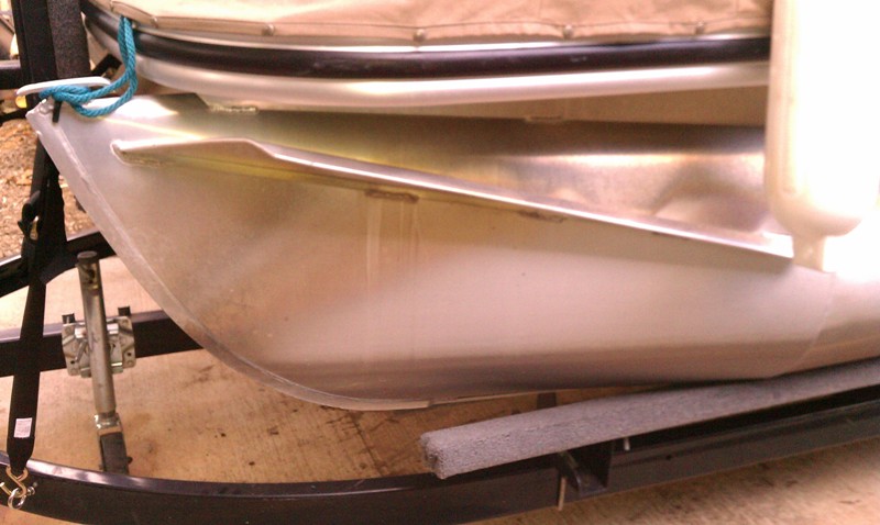

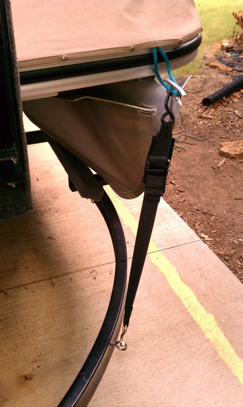

Well hopefully this will take care of the boat bouncing issues -- at least till I get a different trailer.
I went to West Marine and picked up a couple 3/8" eye bolts, lock washers and nuts - installed on the trailer frame as a tie-down anchor points. But I'm still concerned with pulling down on the front of the toon like this -- there isn't really anything supporting under the cones for each toon (see 2nd pic below). This won't cause a crack in the weld for the cone or anything, will it?
- eye bolts installed on trailer frame in front of each toon. new 2" transom strap holding the toons from bouncing.
- tie-down3.jpg (112.37 KiB) Viewed 2626 times
- You can see the space under the cone - is this going to cause any problems?
- tie-down2.jpg (86.73 KiB) Viewed 2625 times

Looks Good! Now just take one and back up your bow winch with it, to keep the pressure off of the bow winch strap and you'll be set! She should trailer real nice! It won't cause any problems with the nose cones, as long as you're using transom straps, it will rest flat and secure! Looks real good to me! If it trailers nice now, why ditch the trailer?
