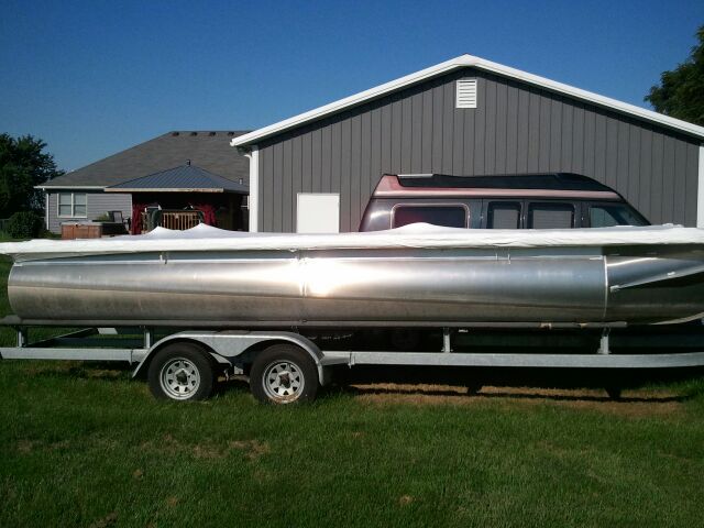

Water line on a Berkshire 223SLX with the BP1 option and a 150
- 2012-08-22 10.00.01.jpg (69.11 KiB) Viewed 1096 times
- 2012-08-22 09.59.53.jpg (53.67 KiB) Viewed 1095 times

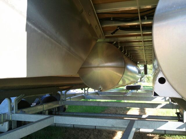

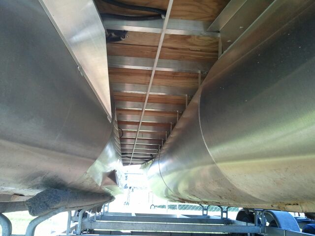

Detail pics
- 2012-08-22 10.00.38.jpg (43.38 KiB) Viewed 1089 times
- 2012-08-22 10.00.14.jpg (46.88 KiB) Viewed 1089 times
