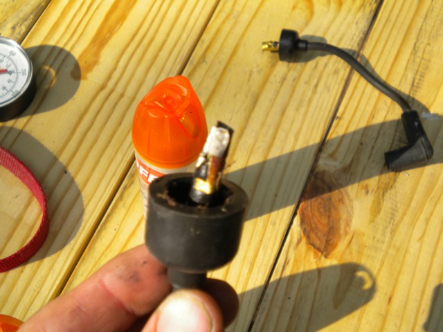

#21 Post by curtiscapk » Wed Sep 05, 2012 8:20 pm
here is my jerry rig from 2 years ago... It was a little different the end burnt (shorted) off and I used a wire terminal to finish the day.
