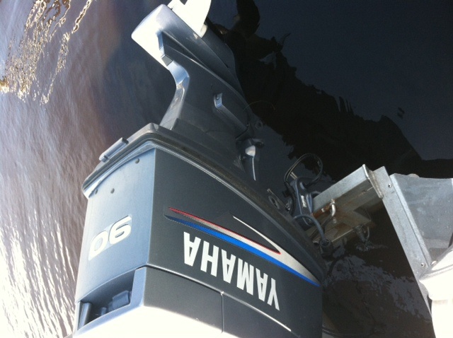

The jack plate would lower the engine more? How much lower would it need to go? When I tilt the engine up now a little bit of the bottom of the shaft is already in the water.

#17 Post by Chris20 » Wed Nov 07, 2012 7:04 pm
You can see it a little here.

We or at least me can't actually determine weather the OP's motor actually needs dropped from the angle of the photo's. What would be maybe helpful is a photo of the motor trimmed down and a photo taken from behind on a level plane with the cavitation, or anti ventilation plate or the plate directly above of the motors propeller. The plate should be more or less level with the bottom of the transom itself. If it's higher ventilation may be the problem and if it's actually low enough then maybe something else under the boat will become apparent or viable.

#22 Post by Chris20 » Thu Nov 08, 2012 6:50 am
Going by the picture on the first page it appears to be lower than the transom!
