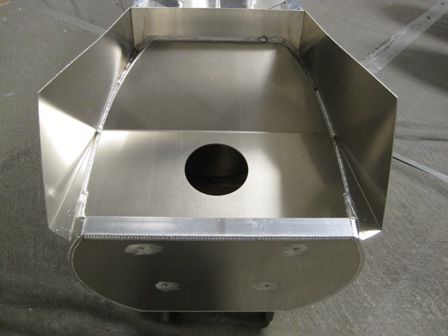

Until 2009 Manitou also had the open transom. After a few design changes we came up with this transom for the SHP when we worked with streamlining the transom pod to where it meets the center toon. We found that the holeshot and time to plane decreased dramatically. And by extending it another 8" back, behind the outer toon's we gained a few more miles per hour. I was going to post this when the thread was still fresh but it took me awhile to find this pic, its on my Manitou Thumbdrive which was in my old briefcase that hasn't been opened since we parted paths.
My Premier is the open design and I think they went closed in 2011? PTX owners, If you read this, is yours closed or open? And what years your Premier, just curious...
Bryan
