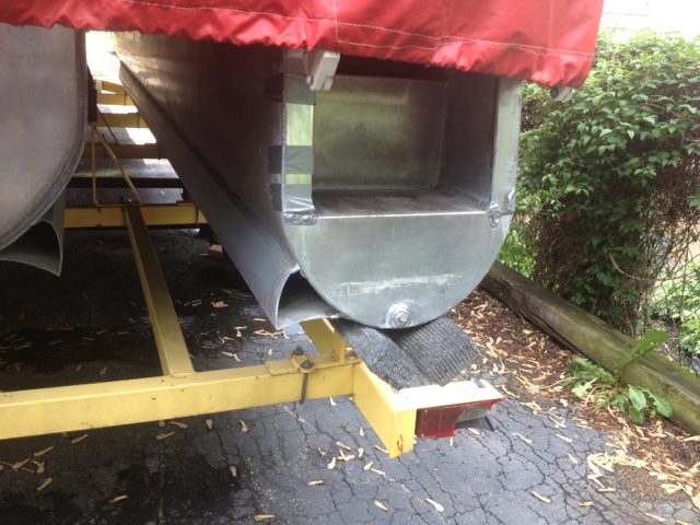

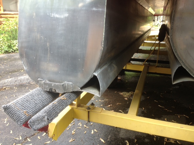

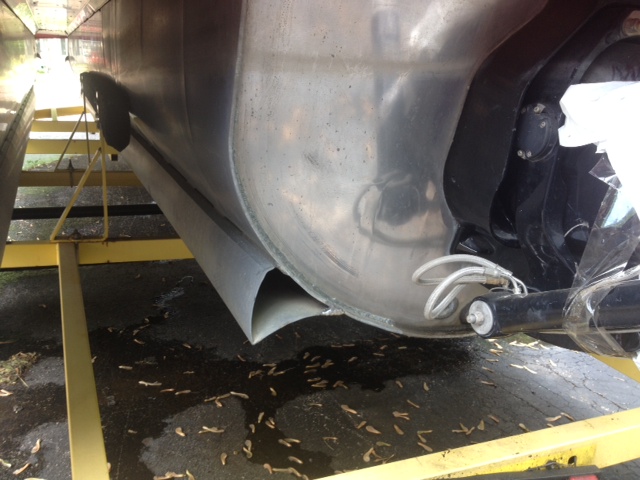

here ya go. JT

Thanks JT i appreciate the pics! Every little bit of pics and info helps as i try to nail down what i want. I'm going to get my fabricator buddy to bend up some short pieces of different angles and dimensions to try to mock up what will work best. I'm hoping to get started on this project in the next month or so. I'll post up some pictures on here to get ya'lls opinions before we start welding. Then it's no turning back.
