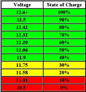

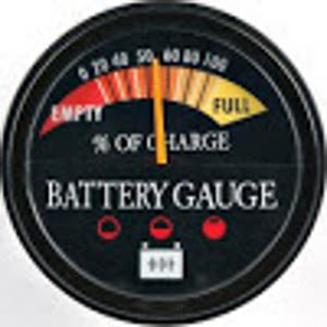

This is what I use to keep a eye on the battery.
- index.jpg (19.29 KiB) Viewed 2132 times
- voltchart1.gif (5.48 KiB) Viewed 2123 times

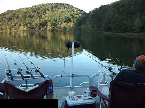

I got this exact one back around 1995 and have no idea how many hours its been used but at least a thousand, its been one tough light. It can be wired in for 12 volt or will run on 6 D cells I have used it both ways on a set of D cells you can get about 4 nights fishing out of it, On the boat I use 12 volt.
I made a mount out of PVC pipe that has one piece screwed on to the front gate and a second piece that just drops in to hold the light up above the fence, cant find the pictures right now though. But will get some .

Knew I had a pic some place
- rod_rack_black_light_-512.jpg (43.77 KiB) Viewed 2063 times
