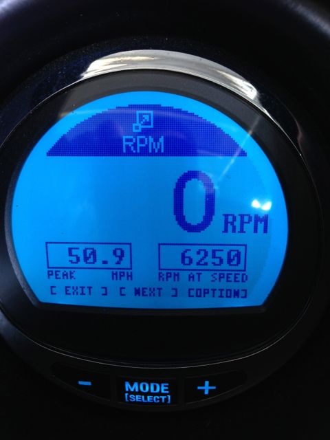

I read both of those tests before I made my decision, so I suppose YMMV on the water. I also did a ton of prop testing, thanks to my dealer, under varied loads and conditions, and took my own very detailed data. My 2275RCW does ~51 GPS with the same prop they used, with nearly full fuel load 45+ gallons. 0-30 is ~6.5 seconds. WOT fuel burn is 26.2gph (1.9mpg), and it's also very good throughout the midrange (3.5mpg @20). Obviously Merc and Yamaha make great top dog engines these days, and like anything, setup matters when you're trying to get the most performance from them. I have no idea why the factory testing varies so much but I'm very happy with the way mine performs so far. My dealer provides great service, so I expect him to keep it working that way.

Re: Vmax or Verado
tms0425, Thanks for your valuable input. You have an awesome performing boat!
Do you have any pics of the underside rear portion of the center tube?
I'm wondering if Bennington my have cleaned up that area in terms of Hydro drag and that might be contributing to your exceptional performance vs the older boat in the test?
Also- have you run ~51ish with the Bimini up and what are your thoughts on up or down for speed and fuel economy?

Re: Vmax or Verado
It's rainy today but I'd be glad to take a few pics of the business end when the weather clears up. I don't really know that they've changed them other than maybe to beef up the transom with a heavy gusset in the well, just in case someone drops a set back jack plate on thereJDB wrote:tms0425, Thanks for your valuable input. You have an awesome performing boat!
It is very clean though. I remember looking at the newer version Manitou transom after Bryan worked with them on it, and this one is similar in terms of flow.
All of the baseline testing I do is with me aboard, maybe 1 extra adult passenger, never less than 25 gallons of fuel. Top is always in the radar position with the bimini boot on, front gate closed, all normal gear onboard including the bow gate seat, coffee table, etc. My bimini is an OEM Schwintek power top and while it's solid, I get a little nervous when it's windy and 50mph+. Top down is certainly going to yield a little on the top end, so I leave it down. I also like to be in a little chop as it frees up the running surface of the ESP a bit. Glass smooth water seems to slow it down 1-2mph.
I'm hoping to try a couple more props at some point, but I'm probably at the limit of what's possible without giving up a lot of punch on the low end and midrange.
Hope that helps!
Tom
