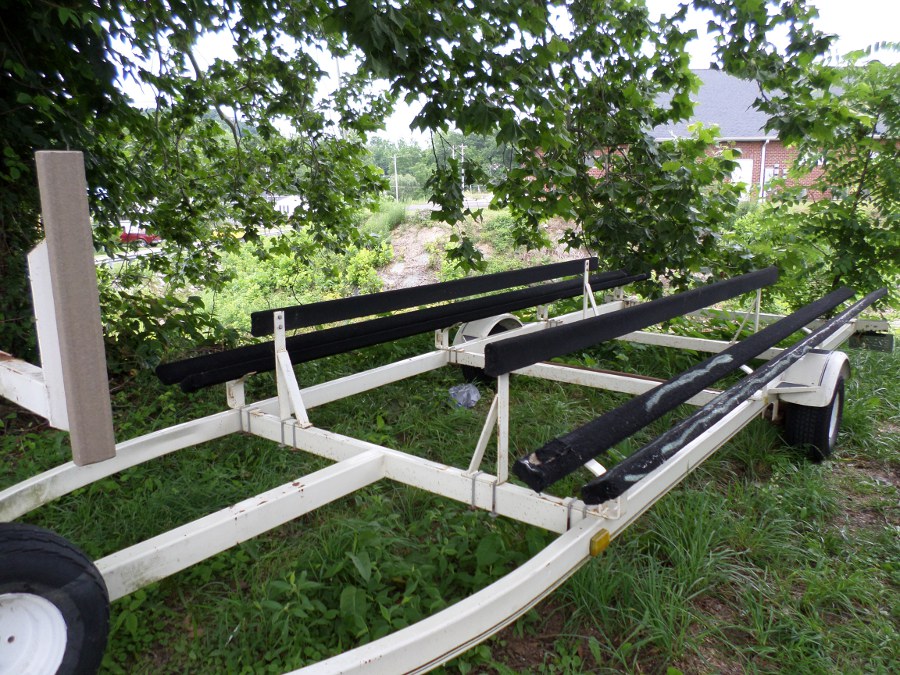

When trying to load in a cross wind the front will end up side ways. Not saying they wont help but the inside glides plain work a lot better. With inside glides I have often loaded in a 25 plus cross wind first time ever time.
Like this
ignore the white streaking on the bunks my grand son was helping me that day lol

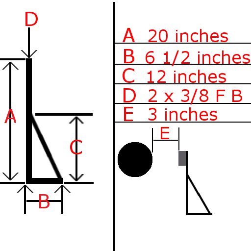

Here is a drawing on the brackets for the inside glides, and you can change the measurements to fit.

Hawk: what gauge/thickness material did you use? Hawk....Do you mean 2" wide by 3/8" thick? Is it flat bar stock? What does FB mean in your diagram?
Waterlogged: Is your metal flat bar stock? What are the dimensions of you metal pieces?
Do you both have the horizontal 2x4s (or do you recommend 2x6s) at the height of the center of the toon?

I don't remember any of my dimensions, but I think the vertical was just over 1 in. and the diagonal was 3/4 in. sq tube. The 2X4 lays right along the center of the pontoon.
