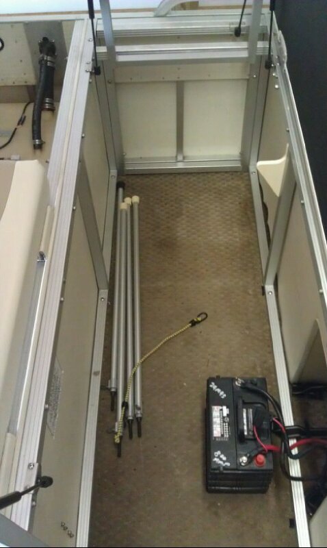

Update on my install. I received the blue seas "mini add a battery kit" yesterday and began my install this morning. The kit had no mounting screws of any kind included, but I guess there is too much variety in where and how it could be mounted for them to accommodate every customer, so no big deal. I actually used a polypropylene cutting board as a backing plate to mount the switch and ACR units to. I purchased the board from Target and its a little thin but plenty solid for my purposes. I spent a lot of time on the forums searching installs of other boaters in the past week. After researching, I decided just how my install would go. My setup is located under the sundeck in the former privacy pop up/storage area, so I do not anticipate much moisture, as I am pretty watchful of the weather and stay close to the dock if rain is a threat. As I am not in a salt water environment, I chose not to use marine grade cables...instead I made my cable out of #2 welding cable lead, using regular copper lugs (instead of tinned copper), hammer and punch crimped then soldered, with standard shrink wrap instead of the adhesive lined shrink wrap. I don't know how long they will hold up but I keep a pretty close eye on my battery cable ends for corrosion as preventative maintenence measure.
I chose to omit the optional start isolation circuit.
I chose to omit the (high price) high amp fuses between the batteries and the automatic charging relay. Blue seas has them on their drawing, in keeping with AYBC requirements, but my positive cables are in no position to rub thru the insulation, and my battery posts are well protected inside the battery boxes.
I plan to show some pics when the install is done.

Here are some pics of my battery switch and "automatic charging relay" installed and ready for the water. I am very happy that I completed this with help from my brother, and all the good information from this forum as well as other forums I browse. The last pic is actually my "before" and the others are the finished deal...
