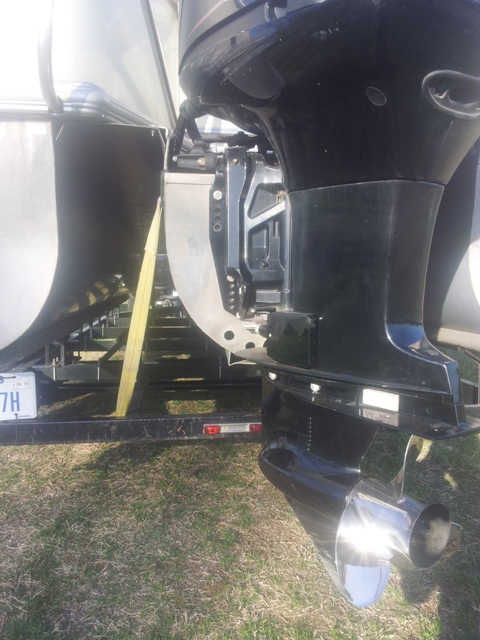

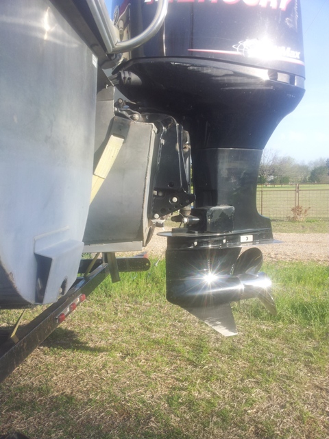

Here's a couple pictures from the side and from the front.
- 20140331_181341.jpg (162.91 KiB) Viewed 1982 times
- 20140331_181322.jpg (158.92 KiB) Viewed 1981 times

Motor's at the right height. But that prop looks TINY! I'd bet that's your entire problem.
(I'm guessing that at sea trials you had the other prop on it right?)

Don't look like a pontoon prop

Is the trim anode missing? Probably not related to your speed problem but it can affect low speed handling.

Dunno if its a problem for you but the little anode that is supposed to be above and just aft of the prop appears to be missing. It also adjusts to eliminate tork so the steering isn't pulling the direction of the rotation. If you have hydraulic steering you may have not noticed it.

I keep forgetting about the anode, but like you said I don't feel it. On a side note, I'm getting more comfortable with the motor and found that the the throttle wasn't opening all the way. Looks like I had about and extra 3/4" of throttle left. Also, the spark plugs are pretty dirty on a few of the plugs. I'm hoping the combination of the two will get me some higher RPMs. If not, I'll go back to trying to find a prop. One other thing, I verified the height of the motor this past weekend. I can see the top of the plate so it looks like that is good to go.
