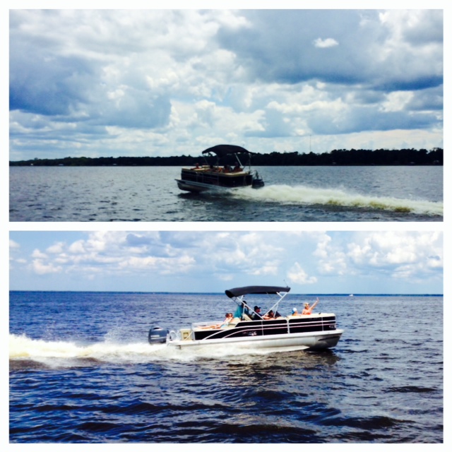

I think 48's a little high... but my 22' Sweetwater tritoon (without outside strakes) runs 44 with 3 people and 29 gallons of fuel. I had 12 adults on it this Sunday, with the top up in the rain and everyone piled under the bimini (toward the rear of the boat) and ran 36 mph with approx 23-25 gallons of fuel.
A friend of mine has a 24' Suncatcher tritoon, fully straked with a 200 Yamaha. With 2 people on board and only a couple gallons of fuel the fastest he's gotten out of it is 46mph. I haven't run mine with only a couple gallons of fuel and one or two people to see the top speed.
All these speeds are from gps since we both have Yamaha's and the speedometers clog when we unload off the trailers
Here's a pic of our two boats from Saturday, I had 6 adults and he had 4 adults and 3 kids and his boat couldn't keep up with mine.
- Lake George.jpg (158.08 KiB) Viewed 21038 times

Not to start any arguments here, but something is wrong with this picture. 44 from that Yamaha, on that boat, with all that weight. With all due respect, sorry it's one of those cases where I'd personally would need to see the proof. 46 from the 200 sounds more in line. I don't expect you to care what I think, but since you posted your numbers...COTTS4x4 wrote:I think 48's a little high... but my 22' Sweetwater tritoon (without outside strakes) runs 44 with 3 people and 29 gallons of fuel. I had 12 adults on it this Sunday, with the top up in the rain and everyone piled under the bimini (toward the rear of the boat) and ran 36 mph with approx 23-25 gallons of fuel.
The pictures don't really show anything, except that you are all having a good time.
