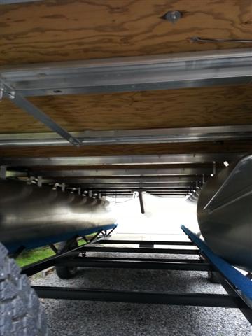

Truthfully I would not have even expected 3/16" C channel to have been used; but your pictures surly don't lie. Pop rivets have a range that they are good for and you should be able to select a thickness that allows for a 1/16" variance. I'm not sure yet if I'll use screws or rivets and I'm not home yet (work on a ship) to look at mine to judge the thickness.

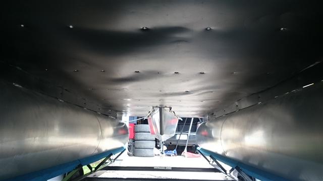

HDPE 40 mill and stainless screw

Re: Underpinning question (or underskinning, underskirting)
Hey guardian667 thanks for joining the thread...
How long have you had the HDPE installed and what is 40 mill?
My plan is to use 1/8" (.125') which is 3.2 MM thick on my toon...
40 mill = 1/24
