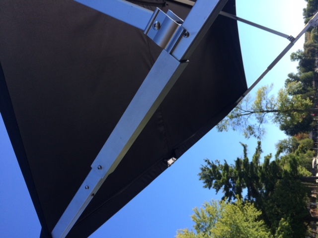

I finally got my 12' bimini top adapted to the 10' Power Arm actuator. I had to get a 1-1/2" box tubing and slide my thin wall top frame into the box tubing to connect to the thick wall Power arm tubing. I had to keep the two original middle canvas support frames because of the 12' span. I also kept the factory front and back supports that connects to the railings for when its really windy going into a head wind at faster speeds. When its down the bimini frames are behind the rear seats and when in the up position it covers the drivers helm. It was a lot of work but to go up the river from the lake I'm on I have to go under two bridges and its hard to raise and lower the 12' top.
