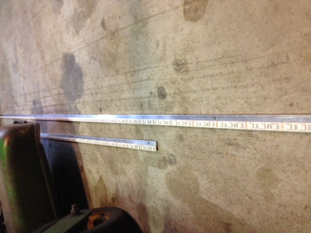

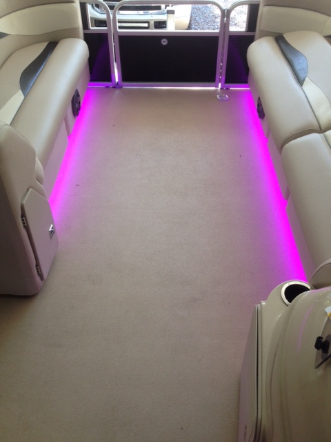

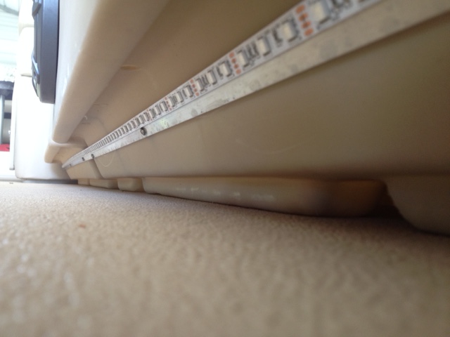

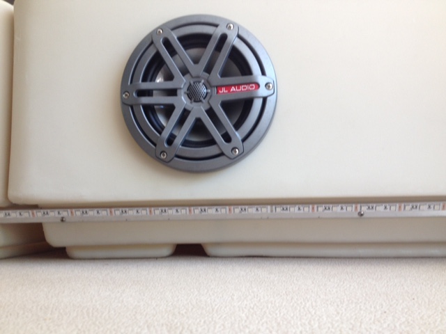

I did my lights half way through last season and after the first few weeks was not very happy with the results. I didn't have a good way to secure the lights under the benches, just tried to use adhesive. I took this weekend to completely redo the project.
I used aluminum channels with a diffuser plate. Then I used extreme temp glue to adhere the aluminum to the benches, then I pop riveted them, those suckers aren't falling off. I've got everything wired to the accessory switch on the dash with a dimmer added in-line. I'm pretty happy with the new results.
