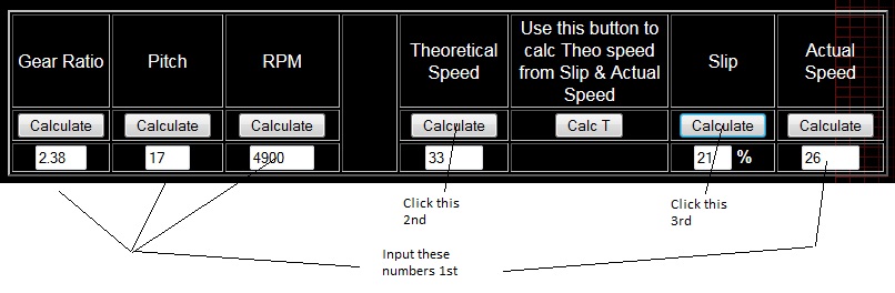

Try this...
- Mike.jpg (61.74 KiB) Viewed 2583 times
Re: 22' Suntracker DLX Fishn Barge - 2015?
I was putting in gear ratio of 2.38:1 Instead of 2.38, all works well now. It shows me a 21% slip, not sure what to do with that to determine a starting point for a different prop??
If you try a 15 pitch, 5500RPM you will get a theo of 33mph. 12% slip is realistic on this boat which will get you ~29mph actual. That is what I am getting with my 2.07 gears and a 13 pitch.
