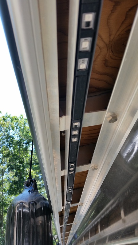

led under lights are in place using 3/4X3/4 aluminum angle with ss self tappers thru the plastic track/ angle into the cross members.

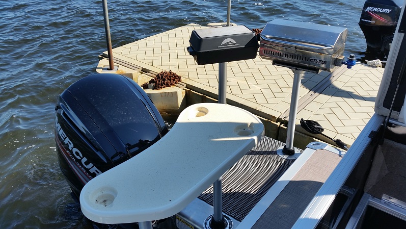

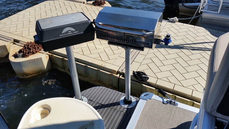

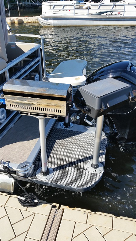

the grill platform is 1/4 aluminum plate with 2 arms down to the back of pontoon. bought both grills at different times. I like them both. The table is awesome because I can come straight from the grills to the plates and people can grab what they want. keeps the sundeck clean.

Thanks for the pictures. You gave me some great ideas on my grill layout.
Re: How have you upgraded your toon?
I use one grill for burgers, which take up a lot of room, and the other for dogs and steak tips. I pre cook everything slightly and vac seal then freeze. It only takes 5 mins to cook all of it that way. We usually have a big crew so time is critical an 2 grills was a must.

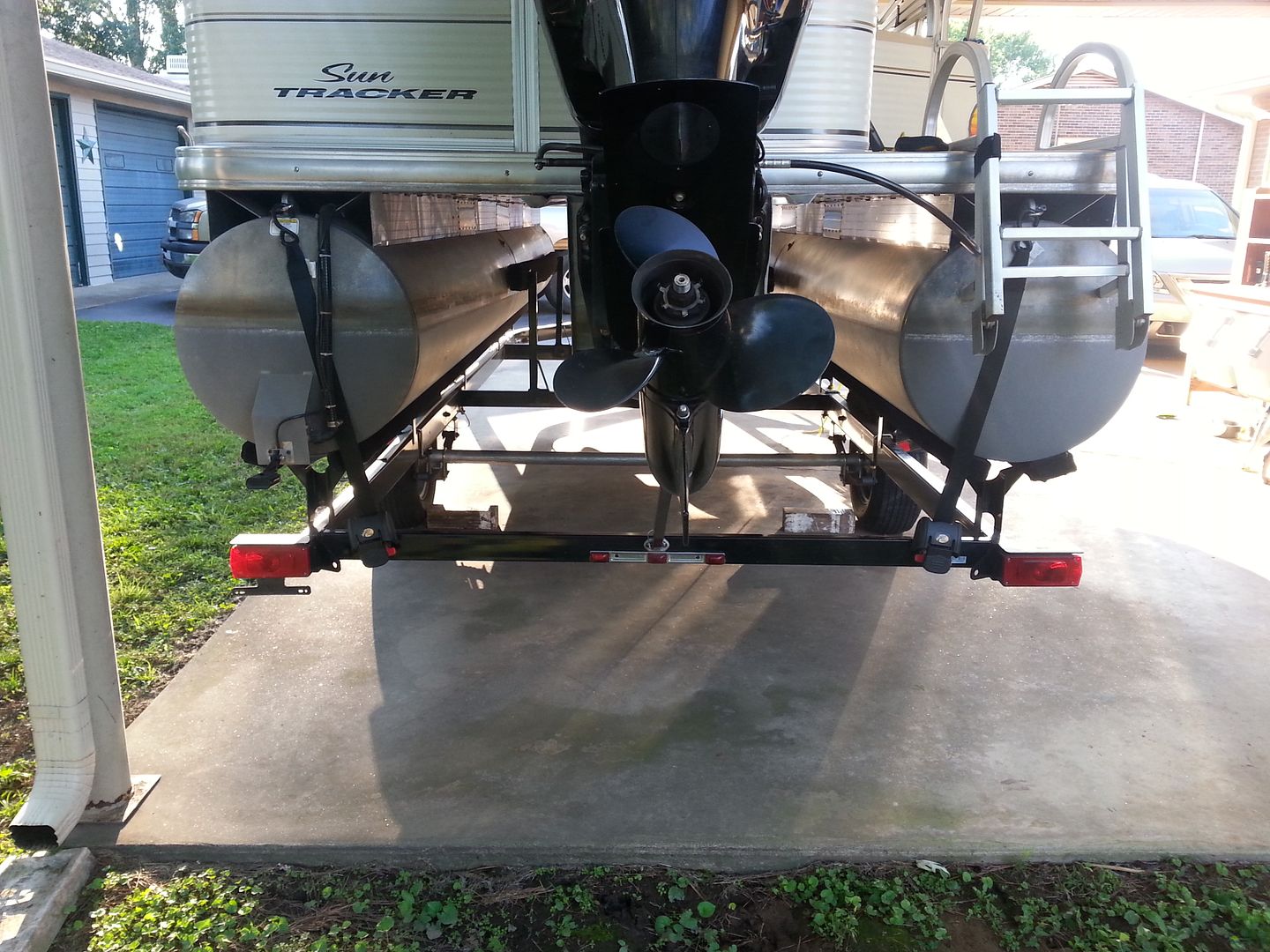

Underskin
Trolling motor
Minn Kota MK-1-DC onboard battery charger (charges trolling battery with engine alternator)
Trim gauge
Docking lights
Rear tie down straps

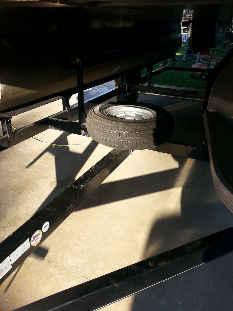

Spare wheel and tire w/mount
Lowrance Elite-5HDI
I seriously need to clean and protect those toons... on my list before next season...

Question on lighting - which looks Great! Any separation issues did you have to use an additional gluing, or just stick backing?
