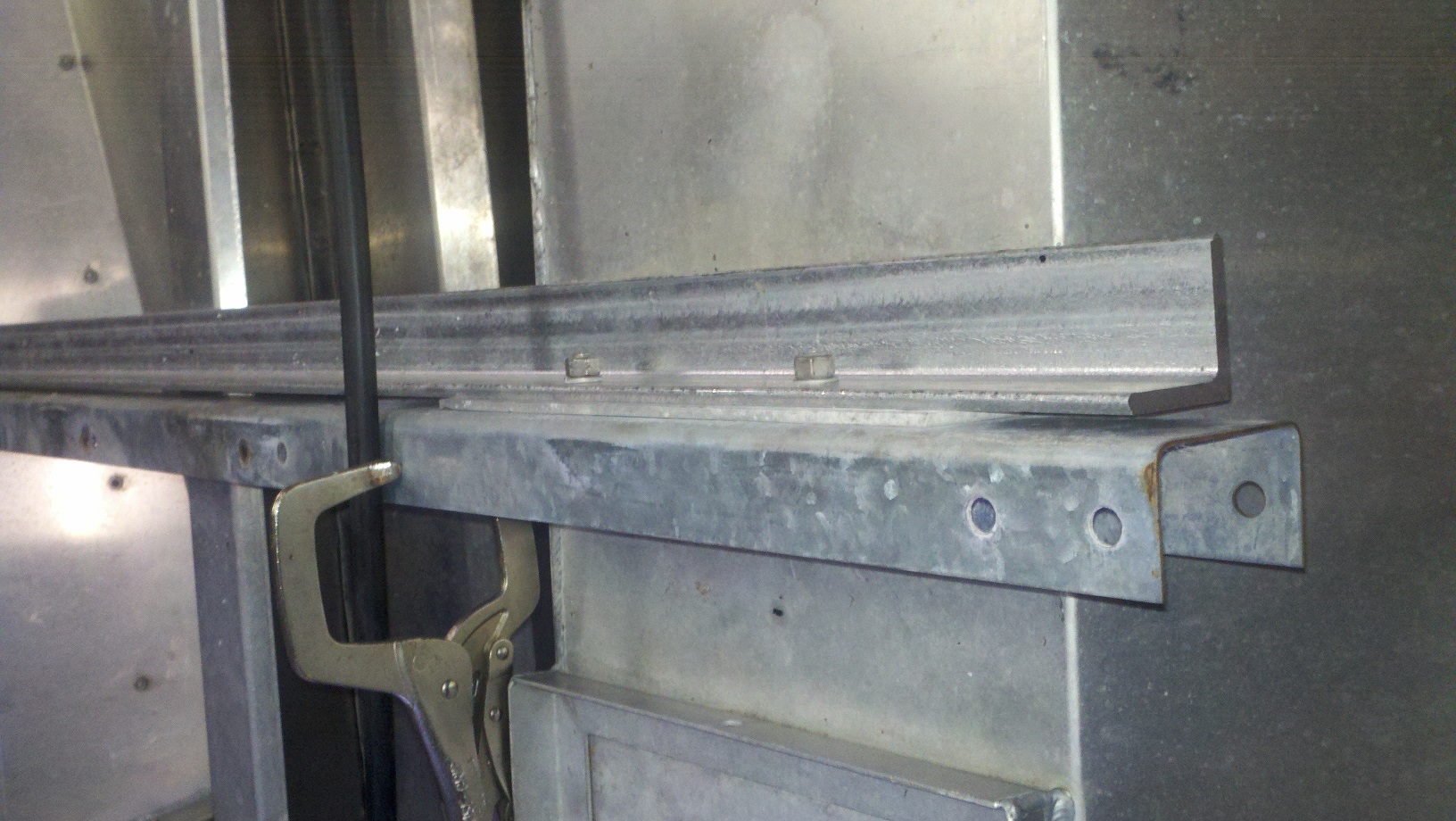

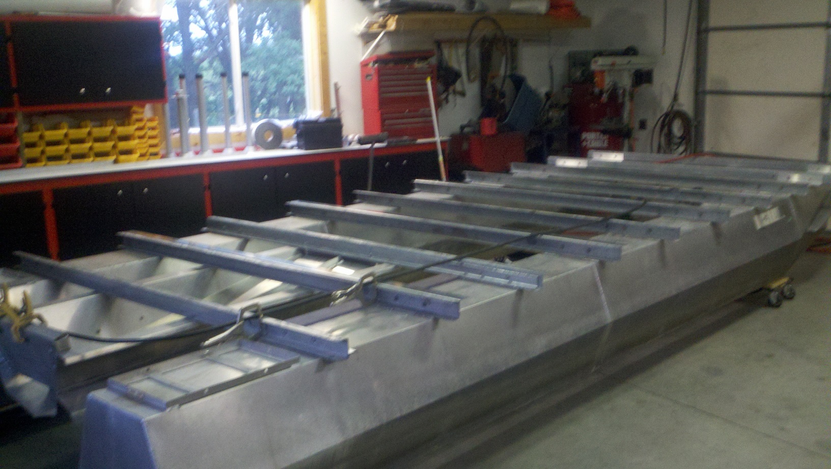

As far as the added weight/power of the larger 4-stroke, I took that into account when I rebuilt the pontoon. On the deck frame I added three 8' - 2x2 1/4 thick galvanized angle iron to the deck frame tying in the logs/deck/motor mount tunnel. Before I added the extra support I could stand on the end of the motor mount and it would bounce. After the supports I can hang my pick-up off the end. Might be overkill but it is strong.

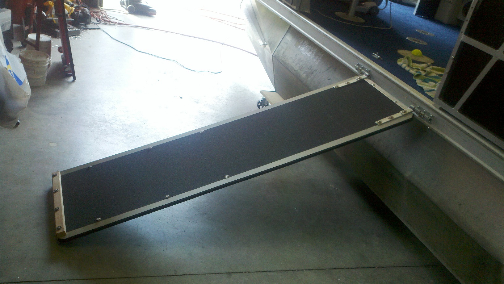

I added a pic of my dog ramp. 6' Fiberglass ramp, 3m traction adhesive matt, two boat cushions underneath.

I like the renovation, it looks great. You have done a fantastic job. But, I think I see what happened... As a rule of thumb, your bow railing and furniture should not extend over the front weld line where the pontoons meet the nosecones. It looks like your center of gravity is pushed way too far forward. I would guess by at least 4 feet. For sure, more stern weight and a bigger motor will help get the stern down. I think you need add more pontoon length or shorten up the playpen, to get you center of gravity back where it should be. I would interested in seeing what this did to your tongue weight on your trailer? Should be about 10 to 15% of the total boat/motor trailer weight. If you weigh 3000 and have 400 pounds of tongue weight, that may be a dead giveaway to your problem... Tow your rig to a semi weight scale and weigh it. Then weigh the tongue weight on a scale.

Yep, that picture definitely tells the story. Those toons have to be heavy also, with those angles I would think the metal would be thicker than the round one's, No? That is a good job though, My Newfy would love that ramp. He hates going from dock to boat.
