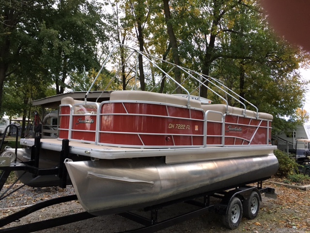

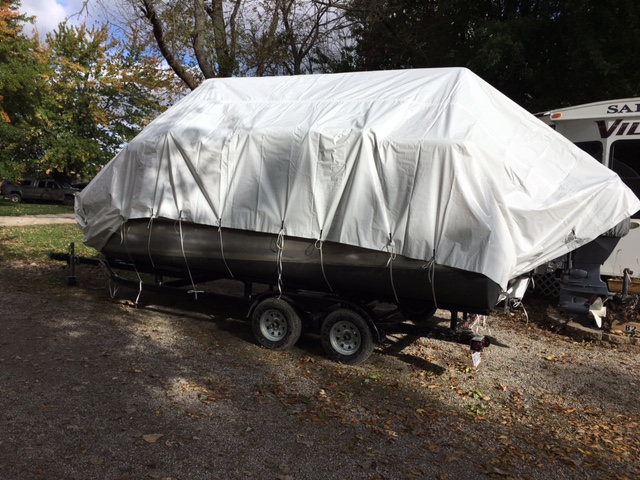

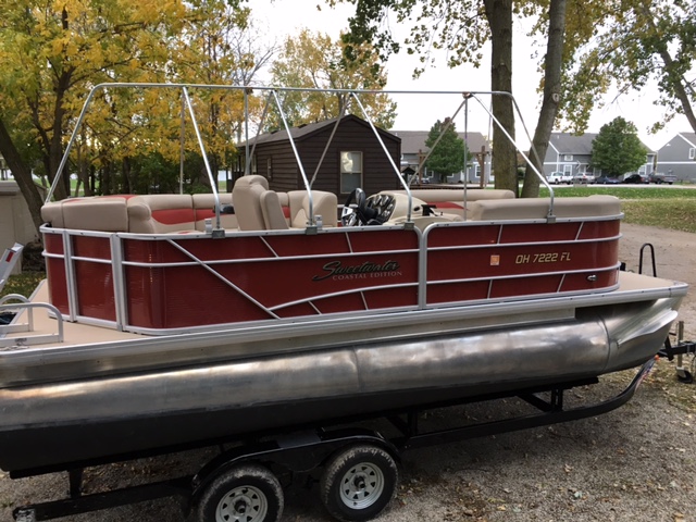

I bought the Kover Klamp system as I mentioned earlier on this thread. Here are some pictures from this weekend when I built it.

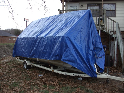

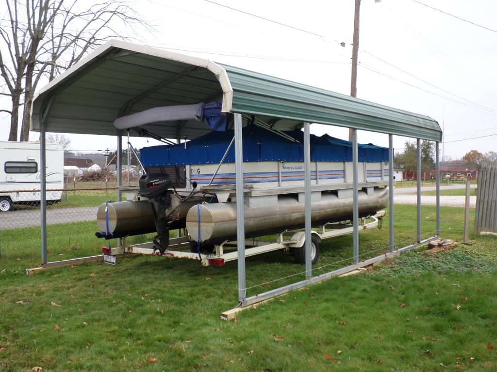

i used to do this, now its this

We had 10 inches of wet snow yesterday. All the snow slid off of my cover. I am very happy with the performance. If it can handle the wet snow I expect it will also work well once we get colder weather and fluffy snow.

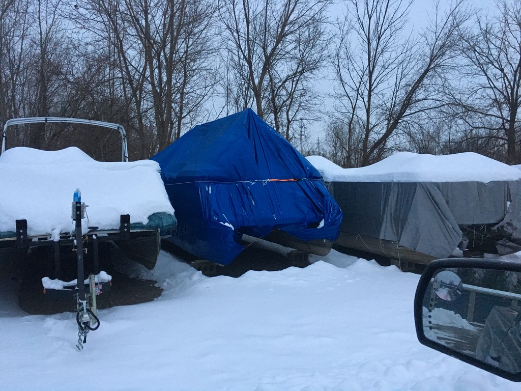

I gotta thank you guys for this thread.
A trip to HD and HF and we got the toon covered for less than $100. And we will be able to use this set up again next year.
It seems to be doing a great job so far. A lot better than our storage neighbors.
We used 2" pvc to make a center frame and some ratchet straps to hold it in place. A 20x30 tarp, bungee cords and some rope finished it off.
We did have one catastrophic failure a few days after putting it on. We had some 50mph winds and the PVC came apart. Ended up with about 8" of water caught inside the cover. We fixed this by cementing the horizontal pvc joints. We left the vertical joints unglued so the frame can still come apart for summer storage.
